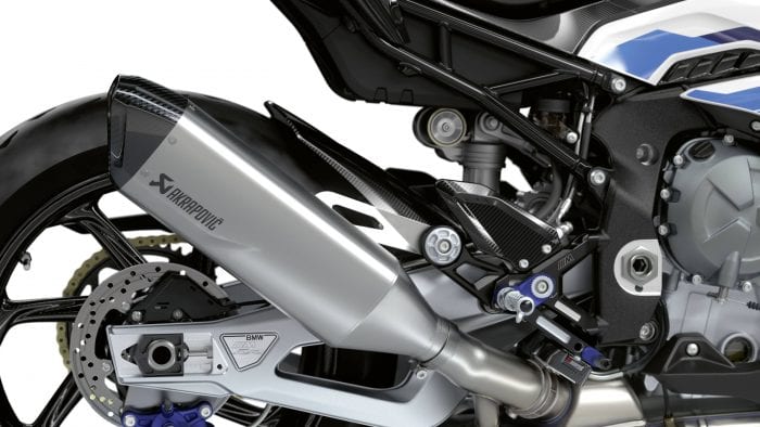

The bike has a 999cc liquid-cooled inline four-cylinder engine with ShiftCam technology. The M-model gets new two-ring pistons from Mahle. These are .4 ounces lighter than the S1000RR’s pistons. The connecting rods in the new engine are titanium from Pankl. This increases the compression ratio to 13.5:1 from 13.3:1 and increases the maximum rpm to 15,100. The M1000RR also gets a new exhaust valve spring assembly and slimmer and lighter rocker arms.
All told, the engine makes 212 hp at 14,500 rpm. Torque is 83.3 lb-ft. This is the same as the S1000RR, but it hits 500 rpm later at 11,000 rpm. The company added a tooth to the sprocket to help compensate for this. BMW also added a new titanium exhaust. This exhaust weighs 17.2 pounds compared to the S1000RR’s exhaust that weighs 25.2 pounds.

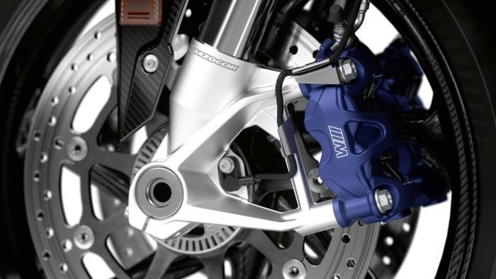

The chassis was adjusted too. The M1000RR’s setting head angle is flatter than the S1000RR. The fork bridge offset was reduced a bit. This results in a 23.6-degree rake and 3.9-inches trail. The wheelbase is 57.4 inches (slightly longer). The rear suspension is a monoshock with fine-tuned adjustment. At the front is a 45mm inverted fork. The fork uses milled bridges made from solid aluminum. The brakes are M-branded calipers developed by the company’s WSBK program. They’re Nissin brakes that have been modified and made lighter. There are dual 320mm rotors up-front, and in the rear, there’s a 220mm rotor.
