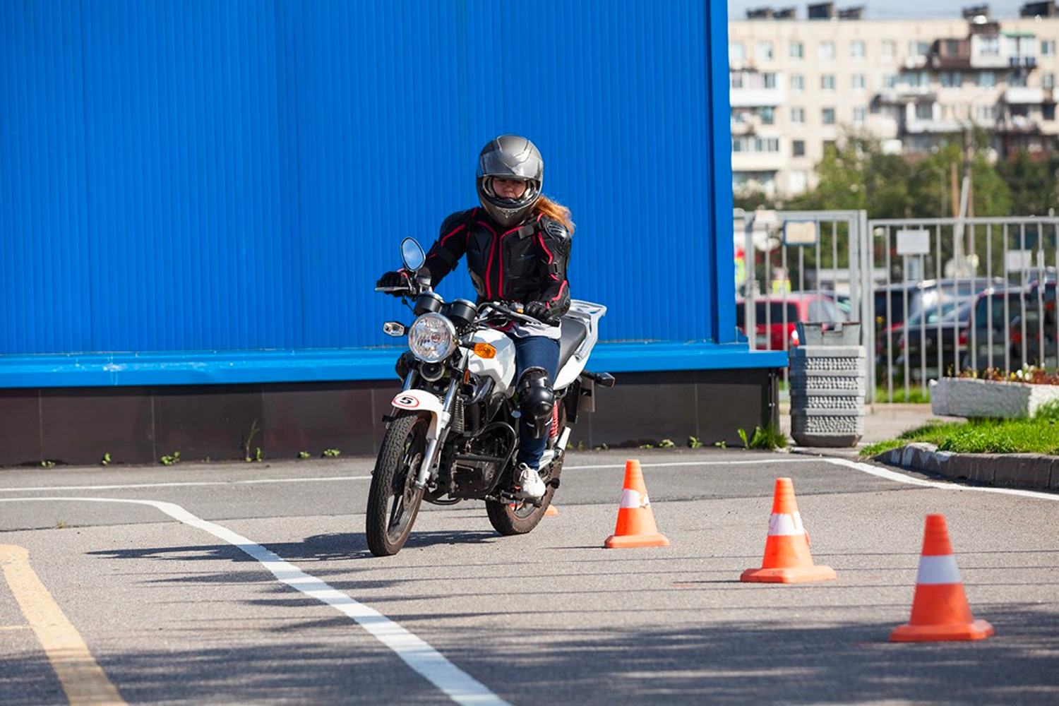

All you’ll need is a Sunday morning, a quiet car park without any pesky spectators, your bike and a few position markers like traffic cones, empty drink cans or even some chalk. Or if you have none of that guff, you can always just use the spots marked in the car park itself to let you know where you need to go.
More experienced riders may be tempted to skip this step and practice on public roads. As you may have already figured out, adding other vehicles to the equation will only make things harder, more frustrating and definitely more dangerous.

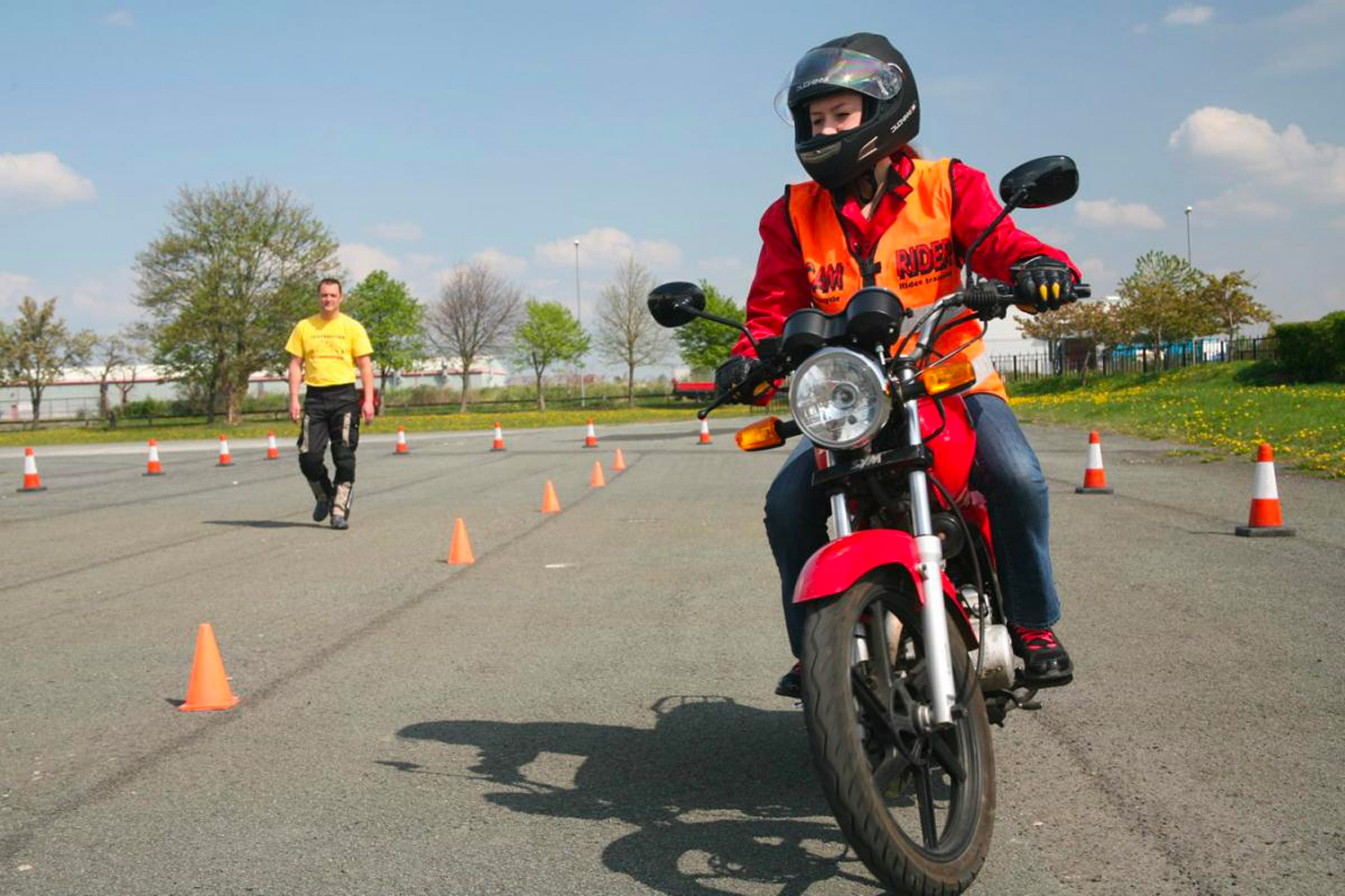

The main skills you need to put into use here are slipping the clutch and using the back brake (not the front!) to reduce your speed to a walking pace without risking a stall.
Personally, I prefer to balance the bike’s forward momentum against the rear brake; just how much throttle, brake and clutch needed in your particular circumstances will depend on your bike’s gearing, torque, throttle map and weight. But the end result should be the same.

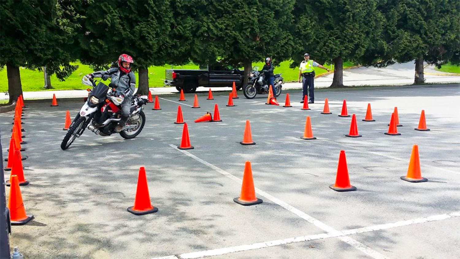

You’ll want to end up being able to keep the bike moving in a dead straight line with minimal wobbles at a relaxed walking speed. If you smell something burning, then you are heating up your clutch too much.
Give the bike a rest and look at applying more rear brake. Once you have mastered it, try setting up a slalom and see if you can ride the bike through it at a steady pace without putting your feet down.

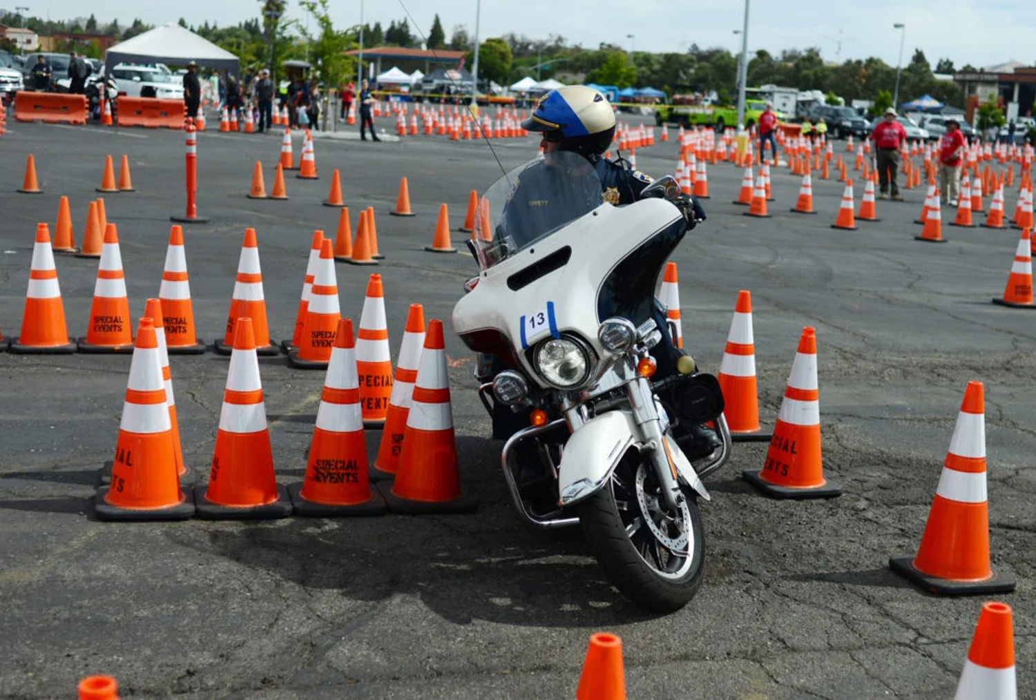

For obvious reasons, motorcycle police are excellent at low speed maneuvers. Image Via: DailyRepublic.com

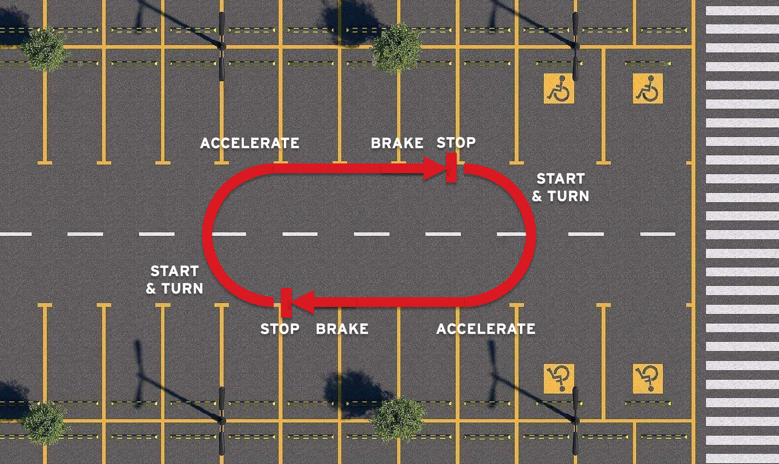

So before we start the actual turn lesson, you’ll need to visualize how you’re going to move around the area. Essentially the practice will consist of two sets of u-turns followed by a brief acceleration and deceleration. Visualize two capital letter “J” shapes with one spun 180˚ so that you have an oval shape.
What you’ll be doing is coming to a complete stop, commencing a u-turn that will see you turning the bike to face in the opposite direction, then briefly accelerating and breaking in a straight line until you again come to a complete stop and then repeating the whole thing all over again. Got it? Great! Now let’s get down to business.
