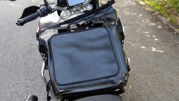

The Wolfman Expedition Saddle Bag utilizes what could be termed a classic shape – somewhat boxy in look but soft-sided with obvious form and strength to the floor and side walls. Their light weight and flexibility are deceptive in seeing how well the pieces keep their shape – empty or loaded.

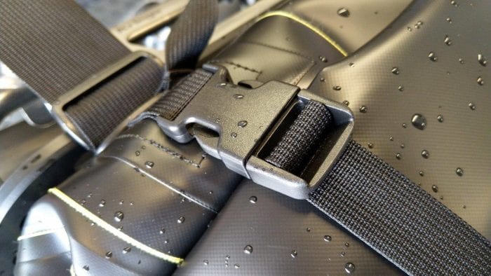

Heavy duty 840D nylon laminated with ultra-strong TPU provides an absolute moisture impermeable layer with all RF-welded sections for a smooth unblemished look with strength and flexibility.
Alloy G-Hook engagement sliders, along with low-profile plastic buckle connectors with friction sliders and quality 25.4 and 50mm (1.0 and 2.0in) flat strapping is used.

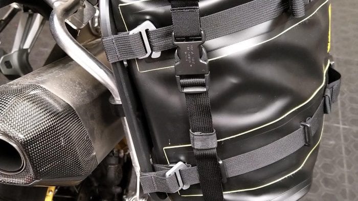

Mounting Strap/Fastener Layout​

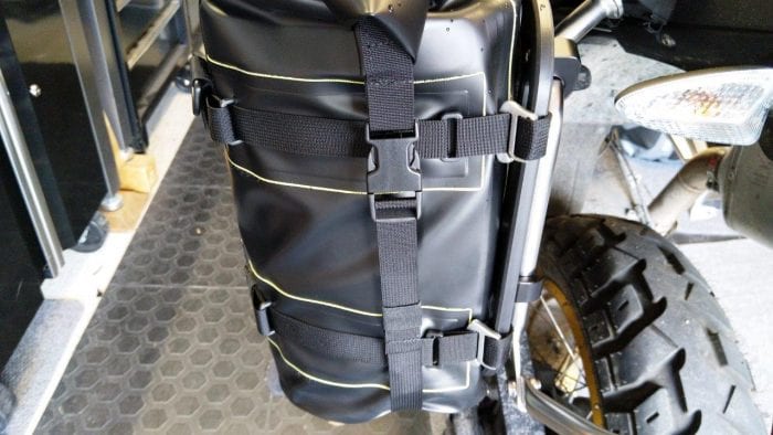

Both bags are identical, so initial fitting of both bags over the motorcycle with side-frames is made easy for this and subsequent steps; Wolfman experience, design insights and features are at the fore here.

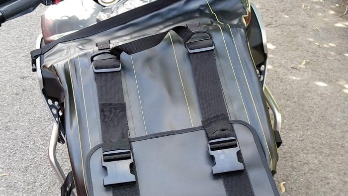

The wide cross-over seat straps with large modular snap-n-click connectors and slide adjusters at each connection end and elastic strap retainers make the initial layout of the bags easy. Getting the optional kit that includes a set of cross-over extenders is a bonus and, appreciated.
Wolfman Expedition Saddle Bag mounting strap/fastener

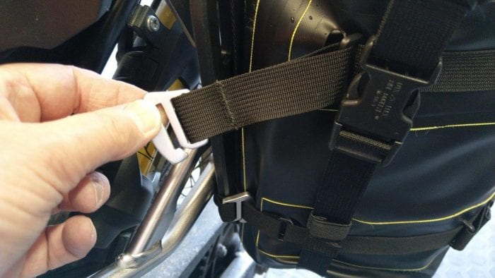

Direct mounting of the individual bags to OE or third-party side frames is done at each corner using alloy G-Hook sliders stitched into the ends of the upper and lower perimeter flat straps.

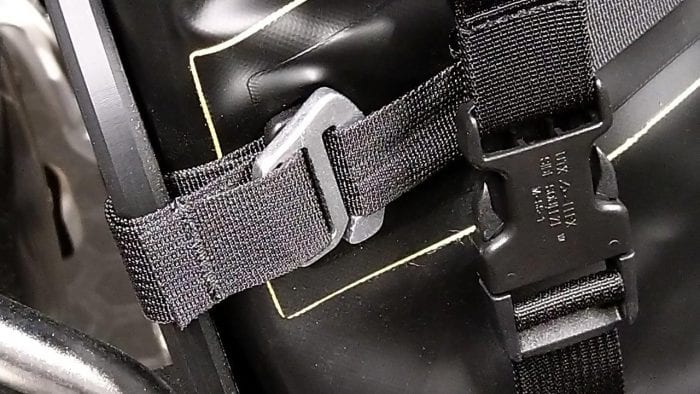

The G-Hook pieces run through and around the side frame or mounting point and loop back on the outer side and slip in over the flat strap.
Each of the upper and lower perimeter straps has two sections, joined in the middle by the buckle/slider adjuster pieces.
With the G-Hook pieces engaged, the two sections of each perimeter strap are connected and tightened up, pulling the bag tightly to and against the frame or adapter mount, which also serves to seat and maintain tension on the G-Hook engagements.
Small plastic pass-throughs, four per side, are stitched into the upper and lower perimeter straps as flat strap mounting points for other Wolfman products, like the Wolf Bottle Holster (under review) or Rolie bags.

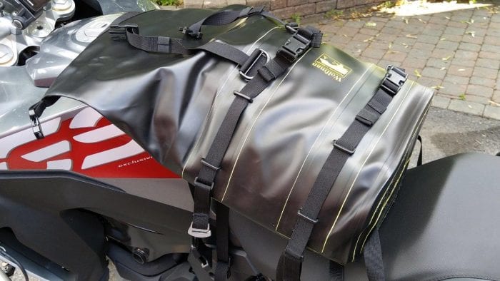

With the bags loaded or just rolled tightly for unladen travel use, the top and side compression straps come into play. There are four adjustable compression straps per bag; two that are pulled over the rolled top and one each for the pull-down ends of the rolled top.
With the bags carefully rolled three times for an absolute seal, the upper and lower sections of the top and side compression straps are connected and then adjusted for optimal compression at the top and sides.

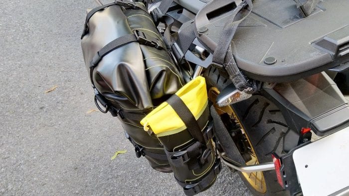

Plastic D-rings on Wolfman Expedition Saddle Bag
You can never have enough attachment points, right? Well, Wolfman obviously agrees, with two large plastic D-Rings stitched to the upper flat straps on each bag.
If the bags are left in place between uses, they can be depressurized and rolled up tightly. With the internal stiffeners removed from the inside liner ‘envelopes’ that secure with hook-n-loop material, the bags compress inwards for an even smaller profile.

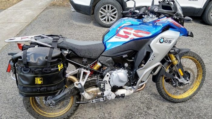

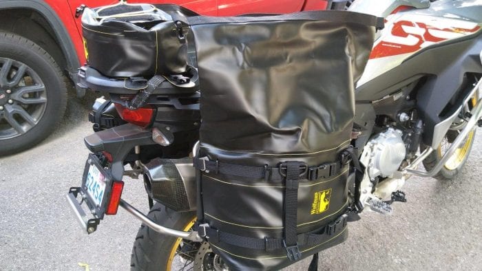

Wolfman Expedition Saddle Bag on 2019 BMW F 850 GS
2019 BMW F 850 GS Adventure​
Both F 850 GSA motorcycles in the home fleet (at the time) – one full-height Rallye model and one low frame in Exclusive trim have the factory installed GS Adventure pannier frames; a now standardized assembly (essentially) identical to the pieces on the R1200/R1250GSA models.
Mounting Exercise No. 1 – GS Adventure Frames​
In laying the Expedition Saddle Bags over the rear portion of the flat Rallye-style seat it is evident that to get the bags dropped further down so they sat aligned with the side frames the cross-over straps needed a bit of lengthening.
This adjustment is quickly done by increasing individual strap length at the adjusters closest to the bags with any final fitment adjustments needed made using the easier accessed cross-over connection points sitting on top of the seat.
But with the Expedition Saddle Bags laid over the seat and OE pannier side frames, the fitment accommodation required for the right GS Adventure pannier frames becomes evident along with the (anticipated) heat-related concern.
The Immediate Issue. To accommodate the exhaust system, the top of the right frame tubing sits close to the motorcycle but then curves out to clear the muffler or can; so between top and bottom, it’s not a one-dimensional (flat) surface, whereas the left (non-exhaust) side is.
Many soft or hard-bag providers used to sell or offer third-party side frame solutions. That was then, this is now, and most vendors prefer to identify or recommend a side frame solution, including some that address the offset issue – fair game. The search is on.
A workaround is needed. But in the meantime, fitting the Expedition Saddle Bag kit directly to the GS Adventure Frames is an outstanding task, one necessitating a workaround of sorts. The workaround turns out to be a section of light plastic tubing with a diameter of 8.0cm or 3.14in.
With this piece secured to the upper tubing of the right pannier frame with long zip ties and the EXP bags in place over the seat, the right bag sits flat against the lower pannier frame tube and the outer edge of the plastic tube vertically – not elegant, but functional.

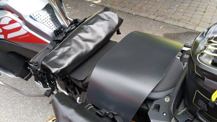

A wool blanket is inserted into each bag for shape and resistance to facilitate mounting and from this point, it only took another 15 minutes to get both side bags attached solidly to the GS Adventure frames.
The G-Hook mounts and strap loops run inside the pannier frame tubing and then back around the outside to slip over the looped flat strap. Again, make sure they are fully engaged to ‘capture’ the strap.
With the bags held in place courtesy of the cross-over straps, the top and bottom perimeter strap sections are clicked together.
Now compress the bags slightly and use the adjusters to tighten the straps up fully which serves to tighten the corner mounting loops and pull the bags tightly against the frames.
Side view of the Wolfman Expedition Saddle Bag
Mounting or removing the Expedition Saddle Bags, empty or loaded, is done quickly (with practice). Loosen or disconnect the perimeter straps to release tension on the G-Hook pieces, slide them off the strapping and away from the frame tubing, lift the bags up and away.
The usual elapsed time to do this is 30 to 45 seconds; putting them back on, perhaps a minute or so. If only one bag needs removing, just disconnect the crossover straps.
With the EXP saddle bags mounted up on the GS Adventure frames, the right side clearance (exhaust to inner side of bag) wasn’t that bad and in use, the removable outer heat shield pad does a good job. For more permanent use, however, a good exhaust mounted heat shield or side frame plate is seen as a good thing to have.

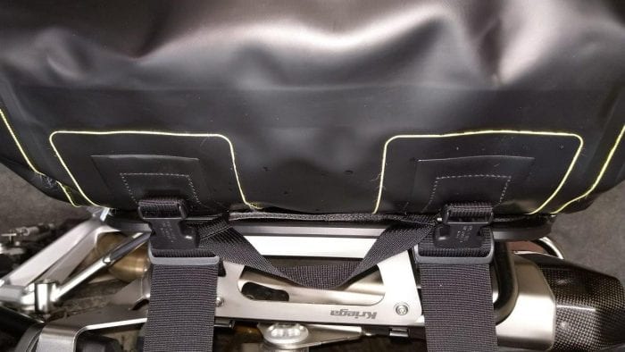

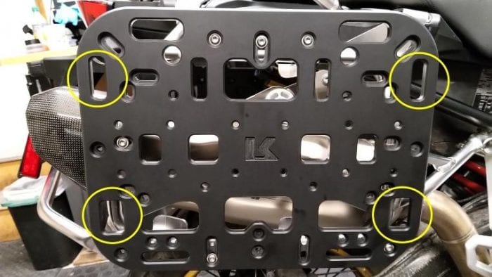

Mounting Exercise No. 2 – GS Adventure Frames with Kriega OS-Platform Kits​
Installation of the Kriega OS-Platform kits is a story left for another review perhaps. Sourcing and getting the pieces was seen, as a potential issue. However – thankfully, it didn’t develop into one.
As a fellow rider wanted a set for his F 750 GS and with the Kriega USA site not reflecting stock, the individual submitted an order for two kits using the UK site and, the two kits made it across the pond within the week.
And in less than an hour of effort, the kit ordered for use with the F 850 GSA is securely installed and awaiting the Wolfman Expedition Saddle Bag WP set. Listed as a special edition, the OS-Platform BMW GS ADV FIT kits provide a stainless-steel adapter to offset the differing tube frame profile along with two lightweight OS-Platform pieces.
The 10mm thick Nylon-6 OS-Platform pieces are 39.0cm wide x 30.0cm high and 1.0cm thick (15.3 x 11.8 x 0.3in) and populated with cut-outs and various sized holes providing multiple mounting options.
The centre of each piece is drilled for RotopaX mount fitting (non-exhaust side fitment please).
The saddle bags are placed over the seat and the cross-over straps lengthened a bit to centre the bags over each OS-Platform. As with the initial GS Adventure frames, the four G-Hook and loop ends are up first.
Pass the G-Hooks through the upper back and front vertical cut-outs on the Kriega OS-platforms and bring them back around on the outside and slide them over the loop webbing (strap).
G-hook mounting points on Kriega OS-platform kit
Note – placement and shape of the upper front and lower mounting arms on the left side and the lower right side of the GS Adventure frames vary slightly between the ‘G’ and ‘F’ series motorcycles. You may find that access to the cut-outs on the Kriega boards is difficult or blocked, preventing the G-Hooks from being fitted in the described manner.
If this issue is experienced, it is a relatively simple matter to lengthen the perimeter straps a bit and loop the G-Hooks through or around the mounting arm or tubing of the side frames and come back around on the outside to slide the G-Hooks into place, then tighten the straps up again. These workarounds are done without impacting fit or security of the EXP bags.
Once all four of the mounting points are in place, connect the two halves of the top and bottom perimeter straps together, compress the bags slightly and tighten up the straps; the bags should be sitting securely in place. Make sure the straps are secure and then wrap or fold up the excess and secure them with the elastic strap retainers.

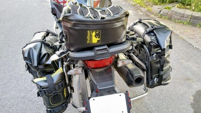

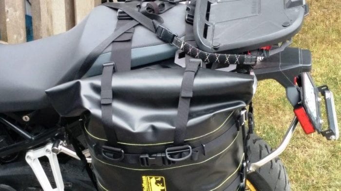

Mounting Exercise No. 3 – Without Side Frames (Throw-Over Fitment)​
In acknowledging that the Wolfman Expedition Saddle Bag (WP) set is not meant to be and should not be mounted without some sort of side frame or side supports, this option had to be given a look and the 2020 F 900 XR is a good candidate for this.
With the cross-over straps shortened up, the bags sit over the seat and outer edge of the passenger grab rail (being replaced with the OE rear luggage piece in two weeks); layout and size are good on the XR. Depending on load and with cross-over strap adjustments there should be about 8cm (3.2in) of clearance between a loaded bag and the exhaust system.
Now it is just a matter of getting a side frame kit. Hepco & Becker is offering a standard tube-based frame kit for the F900XR, but it is not yet available from a NA reseller, so the kit is now on the short order list from DE, although shipping costs will add another 40% or so to the bottom line cost – ouch.

Side close up of the Wolfman Expedition Saddle Bag
Photo of Wolfman Blackhawk Tank Bag, Expedition Saddle Bag, and Wolf Bottle Holster
Wolfman Expedition Saddle Bag mounted on motorcycle
