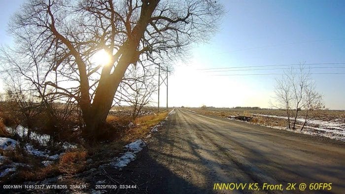

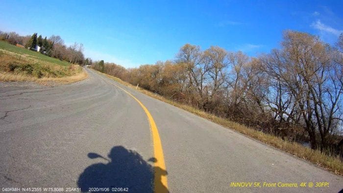

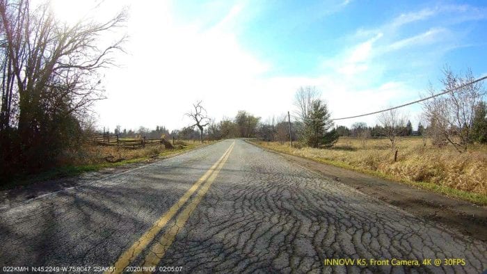

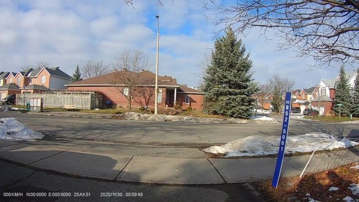

Camera Resolution Settings​
‘Camera Agility’ could be a good term to use regarding the video capture capabilities of the INNOVV K5 system. It provides a total of eight (8) combination options for resolution settings between the front and back cameras, listed in the table below.
All the resolution combinations have been tested, but overall, the 2K @ 60FPS front and 1080P @ 30FPS rear combination (No 3) is preferred for traffic, highway, or paved and unpaved back roads and trails travel.
INNOVV K5 Camera Resolution Settings (wBW Table)
CombinationFront CameraRear Camera
14K @ 30FPS1080P @ 30FPS
24K @ 30FPS720P @ 30FPS
32K @ 60FPS1080P @ 30FPS
42K @ 60 FPS720P @ 30FPS
51080P @ 96FPS1080P @ 30FPS
61080P @ 96FPS720P @ 60FPS
7720P @ 96FPS1080P @ 30FPS
8720P @ 96FPS720P @ 60FPS

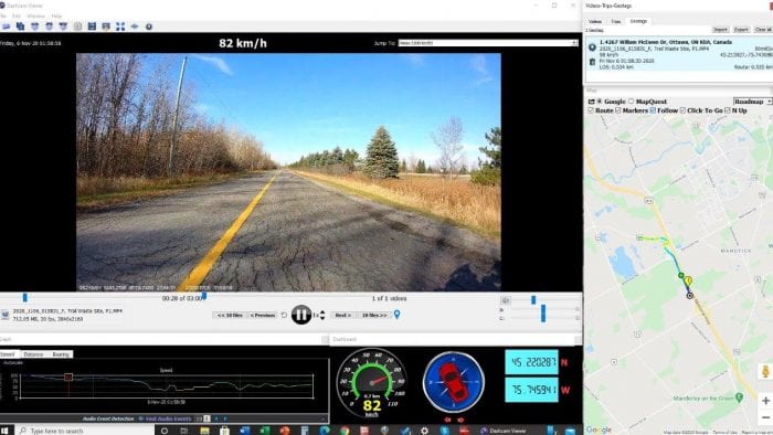

INNOVV camera connected to PC - folder view

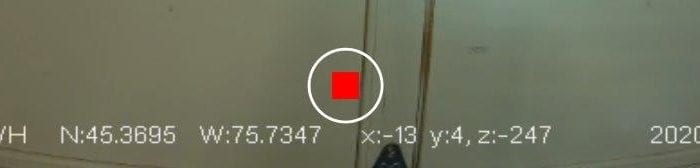

  • GPS feature supports 5Hz tracking in addition to the default 1Hz (1s) tracking

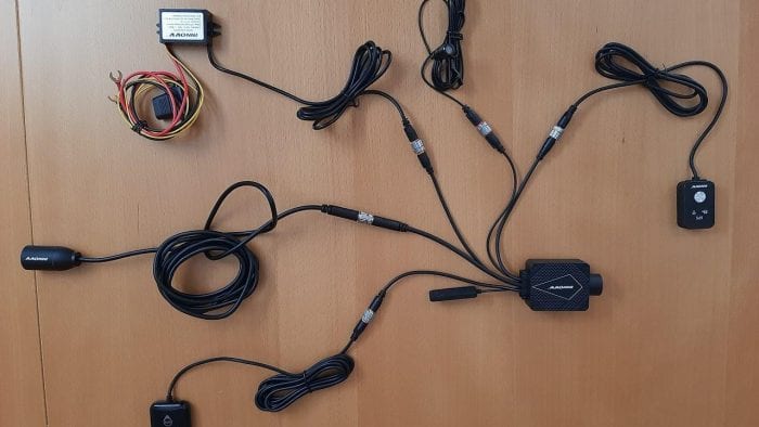

INNOVV Camera system laid out on table

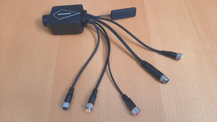

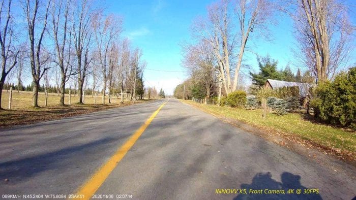

DVR Module/Front Lens – the front lens or camera is integrated into the front of the DVR module housing. The lens is not rotatable, but orientation can be flipped 180 degrees using the ‘Settings’ access on the INNOVV App to accommodate module placement and orientation.
Maximum resolution of the front lens is 4K @ 30FPS, with a 120-degree field of view, 7-Glass +1IR and a F1.8 aperture.
With the camera module facing forward and the top fitted or logo side up, the access port is on the right side; and if mounted upside down, the access port is then on the left side – this can be important depending on left or right-hand traffic, preferred installation side (road or curb) and of course, access to the port under which the micro-USB port and storage media card reside…
On the pre-release modules, the top or logo side is set into the frame and sealed with screws but the updated module to be used with the release version is now one piece for an even stronger housing and even less chance of any moisture egress at any point. The bottom has a raised mounting block with a 6mm threaded insert (see Installation Section).
There are five long(ish) and one short flying leads integrated into the back of the DVR module. The five long ones are colour-coded with keyed multi-pin waterproof connectors on them for component connectivity. The short one is a thin cable with the sealed WiFi antenna housing at the end; handle this piece with some care.
The WiFi cable itself needs to longer and stronger for better resistance to flexing (this observation was one of the first passed back to the K5 team). Note – the Installation Guide specifically identifies that the WiFi antenna (cable) should not be bent sharply or placed in a kinked position.

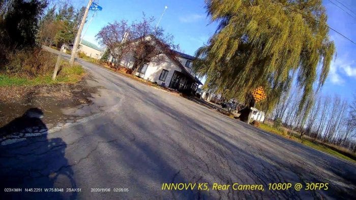

Rear Lens/Camera – a separate component, like the ones used with the current C5 and K2 systems and featuring a ruggedized waterproof housing with sealed lens and integrated connection cable with 6-pin (F) waterproof connector.
Maximum resolution of the rear camera is 1080P @ 30FPS, with a viewing angle of 120-degrees, a structure of 6-G +1IR and a F1.8 aperture. The 25mm diameter rear lens is mounted using a housing clamp, spacer block and the brackets and hardware supplied in the Rear Camera mounting kit (see Installation Section).

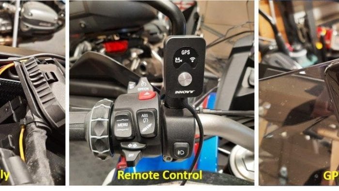

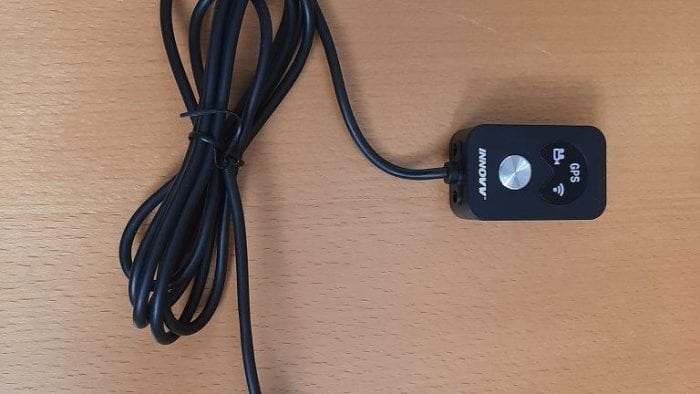

Remote Control (RC) Module – a small, sealed box housing with integrated cable and 6-pin (M) waterproof connector. The face of the RC has a stylized 3-LED display in the top half for the Recording, GPS, and WiFi functions with a Function Button sitting below the LEDs.
The module has a 6mm threaded insert on the back for mounting to either the supplied handlebar clamp mount, considering space and safe access or, one of the supplied L-brackets as a left mirror or right mirror mount – a potentially better placement solution with minimal real estate needed and ‘at-hand’ regarding access.

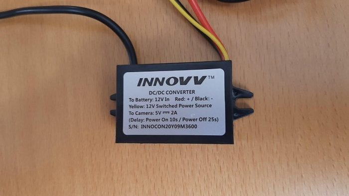

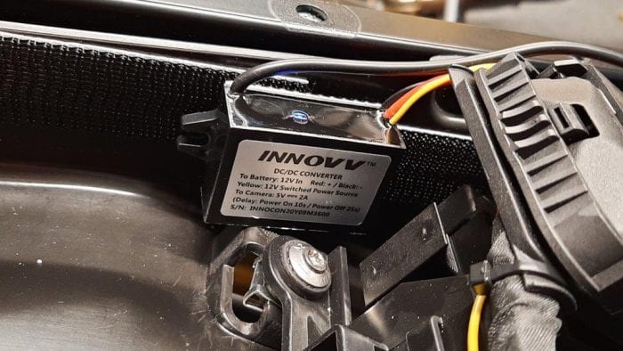

Power Supply Module – a small, sealed power 12V/5V DC management module like the one used for other INNOVV systems. The input harness consists of Red (2A in-line fused) and Black power connection lead set with ring terminals and a Yellow wire for the (SW) ignition source.

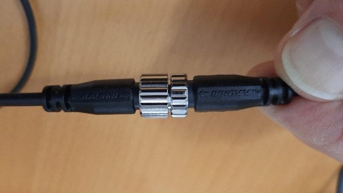

The output harness is a sturdy shielded cable terminated with a 3-pin (F) waterproof connector. Note – a small Blue LED provides an ‘always-on’ indication that the 5.3V supply is good and as this power module is switched, parasitic drain will not or should not be an issue and I suspect that INNOVV has a minimum voltage shutoff threshold as well – its just not identified.
This small module, once outside or inside placement is determined, is easily mounted with the adhesive pads in the kit or alternatively, 3M Dual Lock or hook-n-loop pads, both being plenty strong and less permanent.
The front and rear INNOVV camera system modules

  • 1 x K5 DVR module with integrated front lens/camera, five integrated flying lead cables with keyed colour-coded multi-pin M/F waterproof connectors and WiFi antenna housing
  • 1 x Rear lens/camera module with 6-pin female connector
  • 1 x Remote Control module with 6-pin male connector
  • 1 x GPS module with 3-pin male connector
  • 1 x Power Cable harness with Red/Black round terminal connectors, 2A in-line fuse module and Yellow ignition (SW) lead with 3-pin male connector
  • 1 x Microphone on small clip, with 3-pin male connector
  • DVR and Remote-Control Mounting Kits
  • Rear Camera Mounting Kit and spare hardware
  • 1 into 3 Micro-USB to A/V/Micro-USB interface cable
  • Storage Card Reader
  • Fold-out User Guide

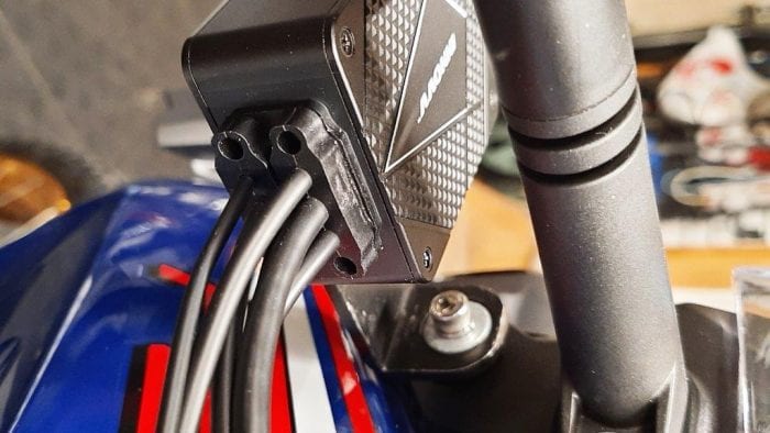

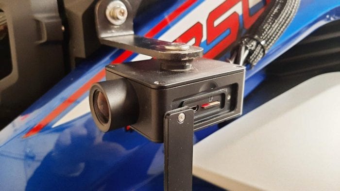

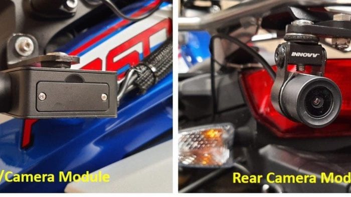

DVR Module/Front Camera – in getting early insight into the K5 form, some initial concerns over the (potential) size and weight of the DVR module with an integrated front lens were expressed, along with (potential) placement issues. But the resultant form factor is small, light, and easy to work with although it does require more real estate and a strong mounting point.
For the K5 retail product, INNOVV has added more brackets and additional hardware to allow even more fitment flexibility of the components; all these pieces are bundled in two well-packed plastic bags.
While a higher and perhaps more centred placement is better for many reasons, an often-used side mounting point just below the left signal light provides a suitable initial mounting spot, with a longer M5 x 25mm screw replacing the OE M5 x 16mm piece and a 5mm spacer used for clearance between the plastic and the small L-bracket from the kit.
But after viewing some first-run video and inspecting the mount closely the M5 hardware layout seemed strong enough but overall, the bracket flexes more than desired, something that isn’t likely to be satisfactory for use on a wide variety of travel surfaces…good suspension or not.

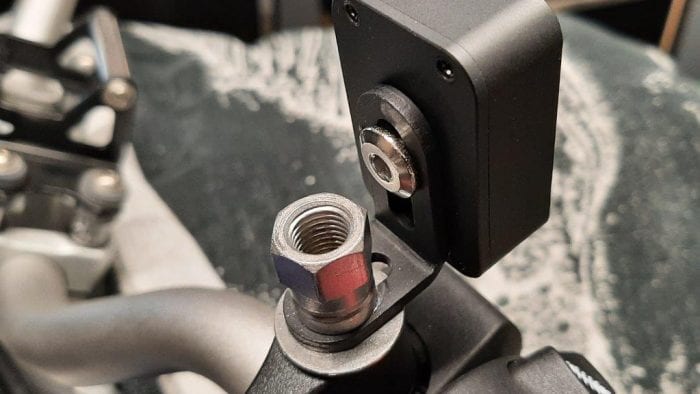

The K5’s integrated camera/DVR module is indeed larger and heavier than the standard camera module, so a heavier duty platform seemed to be in order as a test. The only one on hand, a 2.5in steel L-bracket is heavier than needed but it seemed to be a good piece to try for assessing scale, strength, mounting and stability and, it is.
Using this L-bracket with the module turned over and mounted in drop-down fashion works well; a benefit of this orientation is that direct access to the cover plate is provided for accessing the storage media or micro-USB port.

As always, a rubber cushion washer from the kit sits between the mounting block of the module and the bracket with an M6 screw securing the two pieces together. This layout works well with far less flexing evident.
The resulting video reveals better stability and less vibration or bouncing even on gravel/dirt surfaces, but more testing is needed regarding suitability for prolonged off-road use, especially as there no (apparent) stabilization feature (yet) installed.

Rear Camera – the included bag of mounting pieces provides lots of options for securely mounting the lightweight rear camera using two main approaches, both well described and visualized under the Installation Guide section of the K5 foldable handout; these solutions work very well for C5 and K2 components and now, for the K5 installation.

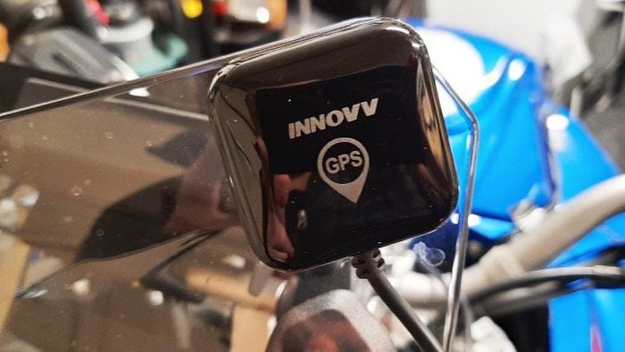

GPS Module – the original GPS module found with earlier INNOVV systems tended to be a bit weak receiver-wise and a clear line of sight positioning worked best – as when mounted to the windscreen or another high point on the motorcycle.
But the newer K2 systems have a more sensitive receiver and placement is as much of an issue and, the K5 GPS component performs extremely well – even in the garage it syncs up to the minimum number of satellites quickly and the small icon on the live view screen goes Green. As such, placement under plastic or the seat is likely to be fine.
But I still prefer an open view – so the K5 GPS module resides on the upper left front edge of the windscreen, secured with 3M Dual Lock rather than the two-sided adhesive. Enough slack is left in the cable routing to accommodate the Lo and Hi settings of the adjustable windscreen.
Remote Control (RC) – the small lightweight L-bracket in the DVR/RC mounting kit bag just needed a slight modification to provide the ideal fitment – the end of the elongated cutout on the short arm of the bracket is enlarged with a step-drill bit until the 10mm threaded insert of the BMW mirror mount adapter is accommodated.
The 16mm wide bracket now has less edge width, but the RC module is an absolute lightweight so there are no load or strength concerns with this modification and as oriented it is well protected by the mirror stalk.
A modification like this shouldn’t be needed for the release version as INNOVV design drawings forwarded for information show some of the L-brackets with V-shaped cutouts so that hardware from 6 to 10mm can be accommodated – slick.
Power Supply – this small module with its input & output harnesses is mounted using 3M Dual Lock to the left wall of the under-deck area, a location providing for expedient routing of the input leads to the battery housing area and the output cable that runs along the left upper frame and up along the left side of the fuel cell centre panel to the collective gathering point.

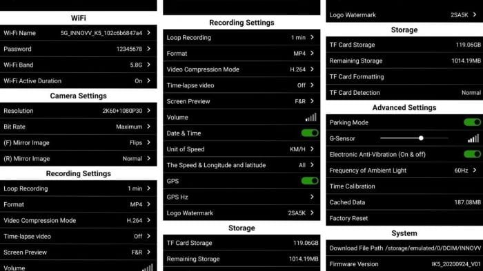

The K5 system is or can be pretty much ‘hands-off’ once the required media storage is installed and formatted, but leveraging all its features and performance requires that the user interface or UI provided by the INNOVV App be downloaded and installed; its’ worth it.
K5 User Interface – the INNOVV App​
The new INNOVV App is for all INNOVV products including the current C5 and K2 models, the pending K5 and models soon to be released. The App is available for iOS and Android. iOS users with other devices (like the iPAD Mini 4 here) may need to select the ‘iPhone’ compatible category to get the INNOVV App listed.
With the App installed, power the K5 system up and once the Blue WiFi LED is flashing on the remote control, turn the smart device’s WiFi OFF, then back ON (or initiate a new search) so the K5 WiFi is detected.
Unless any local or home network connection automatically reconnects (this can be changed), a 2.4G or 5G_INNOVV_K5_xxxx ID listing appears on the device – select this and enter the default password ‘12345678’; the connection is (or should be) made.
If some devices experience difficulties in discovering the K5 LAN ID, try putting the device into Airplane or Travel mode to restrict external or internet connectivity and then turn on (just) the WiFi – the K5 LAN ID should appear and be connectable. This approach also works well with the VIOFO MT1 system.
Note – some Android devices may present a message like, “This WLAN network has no internet access. Connect anyway?” Just select ‘connect’ and all should be good… And don’t forget that both the network ID name and PW can be changed by the user under the App.

INNOVV camera software settings
K5 Settings & Options​
WiFi – the dual-band capability of the K5 is a big positive compared to current systems and some other competitive products. Either the 2.4GHz or 5.8GHz setting is available but using the 5.8GHz WiFi setting is better as it provides a (very) fast and stable connection for preview, real-time monitoring and of course, media downloading.
Note – with the latest firmware build the default WiFi setting is 5.8GHz. Some older smart devices (typically pre-2017) may not find this specific K5 WiFi ID, so the 2.4GHz setting may have to be used.
The user can leave the WiFi connection ‘ON’ or set it to 5 or 10 minutes – useful if this local connection isn’t needed or access to an external network is needed. The WiFi name, password and band settings require a restart of the K5 system whereas the WiFi active duration setting is dynamic.
Camera Settings – the first listing under this grouping is ‘Resolution’. The user has eight front & back camera combinations available, as listed earlier in the Camera Resolution Settings section and listed here again for reference. The default is the 4K@30 and 1080P@30 combination. A change made here is dynamic and made immediately on the system
4K @ 30FPS1080P @ 30FPS or 720P @ 30FPS
2K @ 60FPS1080P @ 30FPS or 720P @ 30FPS
1080P @ 96FPS1080P @ 30FPS or 720P @ 60FPS
720P @ 96FPS1080P @ 30FPS or 720P @ 60FPS
Bit Rate – the (video) sampling Bit Rate (bits transmitted per second) is also selectable: Low, Normal, Height (High) and Maximum – the setting currently used. This setting has more of a resource bill, but (can) provide better overall video capture.
Bit Rate adjustability is a good thing when looking to reduce resource requirements or find a desired median for video/audio quality – this feature is still being played with…
Front/Back Mirroring – both front and back mirror images are selectable as Normal, Mirror or Flips (180-degrees. Given the current orientation of the module, the (F) Mirror Image setting is checked for ‘Flips’ and the Rear Mirror Image for ‘Normal’.
It would be great to have a 90-degree interval setting, but this would involve redesign and resizing of the module to accommodate everything, but one could hope.
Recording Settings (including User Selectable Data):​
  • Loop Recordings – options are OFF, 1, 3, 5 or 10 minutes
  • Video Format settings are – MP4 or TS (requires a restart when changed)
  • Video Compression Mode settings – either H.264 (Advanced Video Coding) or H.265 or High Efficiency Video Coding (HEVC) are selectable; both have advantages and disadvantages
  • Time-Lapse Video settings – if continuous recordings are desired, then this setting is set to OFF, otherwise frame intervals of 100/200/300/500ms or 1s are provided for
  • Screen Preview layout – selectable with either F, R, F&R or R&F layouts, with the secondary view residing in the upper left corner
  • Microphone volume settings – OFF or 20/40/60/80/100% are provided, this is a dynamic change feature although it does not ‘save’ any change and reverts to default (20) on the next startup (firmware fix needed here)
  • Date & Time – ON or OFF
  • Units of Speed – KM/H or MPH
  • The Speed & Longitude and Latitude settings – Off, All, Speed or Coordinate
  • GPS Hz (cycles per second) update rate – current setting options are 1Hz to 4Hz or 1, 2, 3 or 4 samples or updates per second, but the K5 Release Kits will provide 1Hz to 5Hz settings for faster sampling and finer-grain tracking resolution
  • Logo Watermark – is left blank unless a default ID or unique watermark entered, e.g.’2SA5K’
Storage – displays the formatted capacity of the installed media and remaining storage space on the media card. The user can also format the installed media from this grouping and check to see if the media is properly detected, needs formatting or if any error exists.
Advanced Settings:​
  • Parking Mode = ON or OFF
  • G-Sensor Slider (sensitivity) setting – scale of 0 to 10 (0 = less, 10 = highest)
  • Frequency of Ambient Light – either 50Hz or 60Hz, a setting that can help reduce the flickering or strobe effects of lighting from road users or road-side lighting
  • Time Calibration = ‘Cancel’ to leave the default system (GPS) synchronization or ‘Confirm’ to have the K5 system use smart device time
  • Cached Data – shows the size and clears the cached data on the smart device, if applicable
  • Factory Reset = returns all settings to factory defaults.

Video Quality – None of the resolution setting combinations on the INNOVV K5 are ‘bad’, quite the opposite. And while others may scoff at having a 4K capable front camera, you won’t hear me complaining; being able to change camera resolution settings dynamically is a great feature to have in being able to tailor the video capture environment for any activity.
The 120-degree lenses introduce some distortion, but much less (often) viewed when using even wider-angle systems. But overall, distortion is minimal, especially over the longer deeper views. Close-up focus is excellent front and back, no matter the lighting conditions.
In not knowing if the INNOVV K5 has or will have WDR (Wide Dynamic Range) or EV (Exposure Value) features with user-selectable settings, as found and used to good effect with another dual channel camera system recently reviewed, it seems the INNOVV K5, even with its front camera versatility is or could be at some disadvantage here.
The adaptation or compensation differences between the WDR and EV features of the other system when viewing video recorded on both systems travelling over the same terrain in almost exactly the same weather condition is most telling; the other camera shows virtually no transitions whereas the K5 copes, but the video is darker.
Front lens wise, using the 4K @ 30FPS and 2K @ 60FPS resolutions are the go-to settings, although the 2K @ 60FPS generates the best median video – excellent video with very good overall lighting and minimal artifacts observed over any terrain or any speed.
From a rear lens perspective, video from either the 1080P @ 30FPS or 720P @ 60FPS resolution settings is also excellent – far better than the K2 units and, better than the fixed 1080P @ 30FPS of two other systems here.
Only a couple low light or night-time runs were made with the K5 (my fault) but this system, like the current K2s used, performs extremely well with minimal loss of clarity from the front or back cameras in discerning distanced objects and focus is very good in traffic under virtually any lighting condition.

To access the storage card, or micro-USB port, access the cover plate and remove it using the (supplied) small Phillips screwdriver (the screws will not fall out). Push the storage media in slightly to activate the spring-loaded release and remove the card.

Media Playback – there is no shortage of playback applications available. But the list is a bit shorter regarding applications with the ability to playback multi-channel video/audio recordings along with encoded data like speed, heading, position, etc. and, have everything presented in one dynamic screen display.
A long-term favourite is Dashcam Viewer by Earthshine Software. Available in three flavours – Free, Standard or Pro. The Free version provides a basic feature-set that is then built upon for the Standard and Pro versions.
The screen snippet below shows a standard Dashcam Viewer screen with mapping and other discrete displays for the decoded data.

Documentation – is in the usual INNOVV form and standard – succinct but good, but the somewhat complex component and connectivity diagram and the motorcycle installation layout view need to be larger and more colour detailed. Once the product is formally released all this information and more will be available on the website…but the handout needs some changes.
Cable lengths – in using three different styles of motorcycles for layout, working out median cable runs between (probable) positioning of the module that is both the front camera and the ‘go-to’ point for all component connections reveals that the current lengths can be just adequate or somewhat short, forcing installation compromises (see Change Summary below).
As such, increasing the module interface leads by 15 to 20 cm or the individual component leads by the same amount would provide far more installation and routing flexibility.

  • DVR Module – top cover no longer separate piece, but integral part of the housing for increased strength, less seams, seals, and hardware for better elemental protection
  • Module Access Port – M3 thumbscrews now used for easier removal of cover plate
  • GPS Feature – supports 1 to 5Hz (or 1.0 to 0.2s tracking resolution)
  • Default WiFi setting is now 5.8GHz (2.4GHz is still available)
  • Electrical interference issue mitigated for better audio recording
  • Microphone & WiFi Antenna cables made stronger and reinforced
  • Cable lengths increased: Rear Camera now 3m, Mic & GPS now 2m, Power Supply now 2M and there is an additional 3m extension (available) for the rear camera if needed

  • Small light-weight component well-made & ruggedized
  • System is IP67 rated to withstand the elements

  • Water-proof connectors & keyed colour-coded connectors simplify installation

INNOVV K5 Camera System Image Gallery​
INNOVV firmware main screen
Reviewing INNOVV captured video
INNOVV camera module with SD card slot
INNOVV camera power supply, remote control, and GPS module
Retail box contents of the INNOVV camera system
