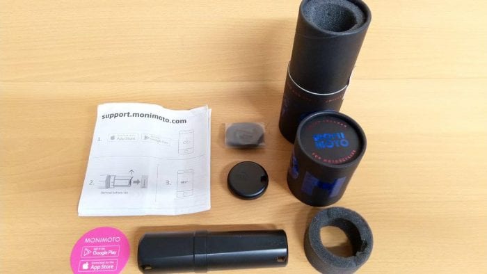

What’s In the Tube
Everything needed, less your own smart device, is carefully packed (tightly) into an attractively styled round container. Once the “Do not Accept if Seal is Broken” seal is peeled off or cut, the top outer tube section is slipped off to reveal the Monimoto module sitting securely inside cushioned with foam rounds.
  • Monimoto Device, cylinder shaped, 126mm x 35mm (4.96in x 1.38in) height x diameter
  • Monimoto Keyfob, round, 41mm x 10mm (1.6in x 0.4in), diameter x thickness
  • 2 x releasable/reusable zip ties
  • 2 x CR123A batteries for Monimoto device (installed)
  • 1 x CR2450 battery for Monimoto Keyfob (installed)
  • 1 x micro-sized international SIM card with two months free subscription (3.50 USD/month afterward unless own SIM installed)
  • 1 x multi-language fold-out Instruction Sheet (the full User Guide is on-line only)

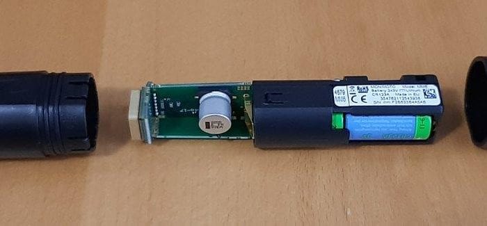

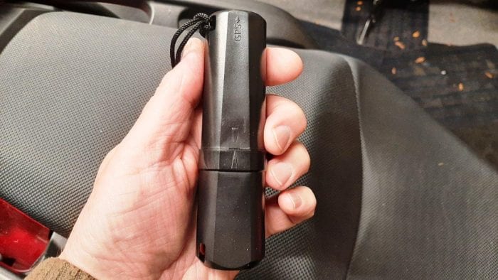

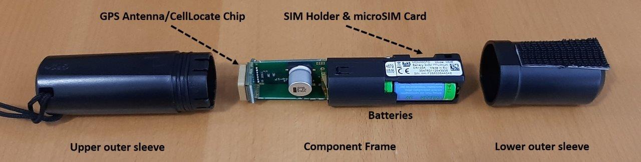

Monimoto Module – the core of the system is contained in a slender tube-shaped housing with tightly fitted removable sections. The module houses: the GPS antenna; Accelerometer; GPS, SIM (GSM), and BT modules; system processor; SIM card slot; and batteries.

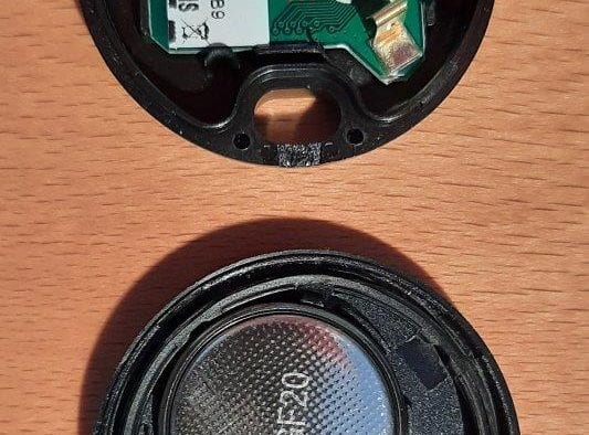

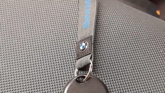

Monimoto Keyfob – the companion component is the Monimoto Key or Keyfob, a round plastic housing with electronic components and battery inside to provide wireless BT communication between it and the Monimoto module.
The Keyfob is meant to be kept on or near the owner all the time and is best not used as part of the motorcycle key set, but kept separate to minimize the risk of the Keyfob disappearing along with the motorcycle and any motorcycle keys.
Three Keyfobs can be paired to one Monimoto – something that can prove useful if the platform the Monimoto is carried on is shared with other users. You can pair one Keyfob to multiple Monimoto devices, but only use one device at a time, e.g. – car or motorcycle.

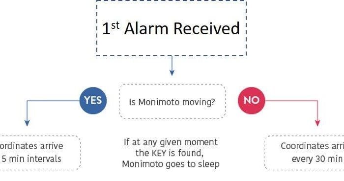

Monimoto Diagram No. 1 – Decision Tree:
Monimoto GPS Tracker alarm decision flowchart

Communication Observations – Monimoto is not a real-time device and does not maintain a permanent connection with the GSM network, but only connects when Alarm Mode is triggered; this is an energy-saving implementation and does not impact function.
Monimoto originated phone calls will be listed under the Phone listings on the paired device and all calls and tracking data messages are entered into the Monimoto App Events Log. These updates continue until the motorcycle stops moving (see Alarm Mode Insights below).

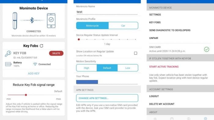

Monimoto GPS Tracker software app
Setup, Configuration & Testing​
Setup and configuration of the Monimoto does not take much time or effort really, but as there are physical device components in use, initial testing of the Monimoto is best done on the bench, before the Monimoto device module is fitted into that hidden and possibly hard to access spot on the motorcycle.

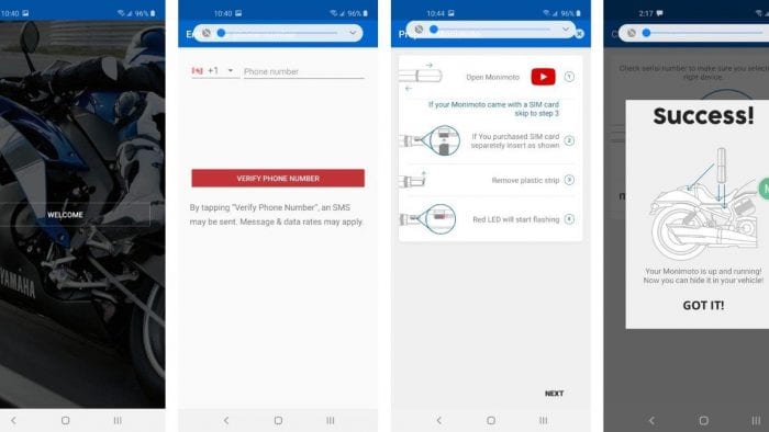

Put the personal smart device being used, the Monimoto device and Monimoto Key Fob close together. Make sure your data connection and/or WiFi is on and Bluetooth. But do turn off BT on nearby devices if possible, especially if you have lots around, like I do.
Monimoto App and the Installation Wizard – setup of Monimoto is mostly done via the Monimoto App and its resident Wizard; download the App and launch it. The first thing it will ask for is your phone number (it does not need to be the phone number of the device to be used with the Monimoto but it does need to be SMS capable/enabled); this number becomes your account ID as well.
With the number entered, press the ‘Send confirmation code’, and then enter the confirmation code that you will receive by SMS. Note – most Android users will not need to enter the code manually as the Wizard does this automatically and the next screen should appear.
From here, follow the Installation Wizard prompts up to when your Monimoto is found. You now enter the User information – a meaningful name for the Monimoto is good and the smart device phone number for Monimoto to call you on if it goes to Alarm Mode.
Once this is done, choose a ‘Profile’ (default is Motorcycle) and then tap ‘Next’ and let the Wizard continue to do its thing, it might take a couple of minutes.
After the pairing and test processes are completed, a ‘Success’ message appears and within a few seconds the first SMS message from Monimoto is received with the dispatch phone number listed – save this number to your contact list so you and your device will recognize it immediately in case of an Alarm.
Press ‘Next’ and the Home Screen comes up showing battery status, system status which should be a Green checkmark indicating Ready Mode (a Red X indicates Alarm Mode) and Keyfob identification and its battery status. The last communication logged with the system is always shown on the bottom of the screen.
With the initial Nokia 7+ setup and configuration, no issues were encountered other than a couple of minor user/operator finger glitches and Monimoto was up and running in about three minutes – a sign of good design and sound process engineering.

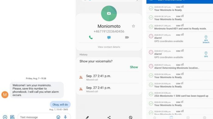

Testing Success – per the Monimoto instructions, the Keyfob is left on the garage workbench, the Monimoto App exited, and BT turned off on the phone (for this initial test). The Monimoto equipped motorcycle is taken out for a test ride up around our main drive that exits on to a main city road, so about 600m line of sight from the house (50m or 165ft is recommended).
Before reaching the main city road and within the first minute from when starting to move the motorcycle, the first phone call, not acknowledged was received and within a few seconds the second call came in – that was acknowledged (the test team being connected by Bluetooth headsets); all good so far.
In driving up along one, then a second main city road and stopping at various points for a few minutes to make sure the push tracking messages would be generated and sent to the phone the ride was concluded.
And once back in the garage, with BT turned on, the Monimoto App launched and the Events Log viewed, it was all listed as it should be – the first message said Monimoto was moving and that a location would be forthcoming, which it was on the subsequent and following push messages. Clicking on the small location icon has the map position displayed – sweet.
With continued use and in leaving the Keyfob at home or at another location, test sessions on the road, parked in sheltered areas or in a concrete covered parking area have not stopped Monimoto from alarming, calling, tracking, and pushing position data – typically to within 10m (33ft), which is good for our area of GNSS coverage.

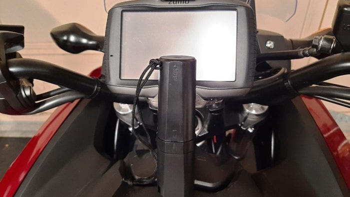

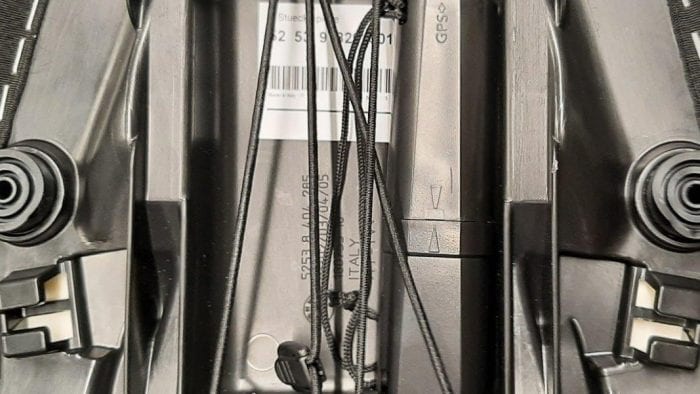

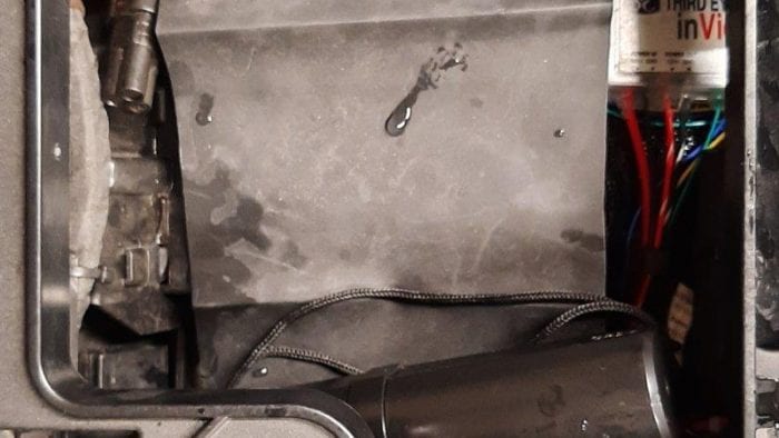

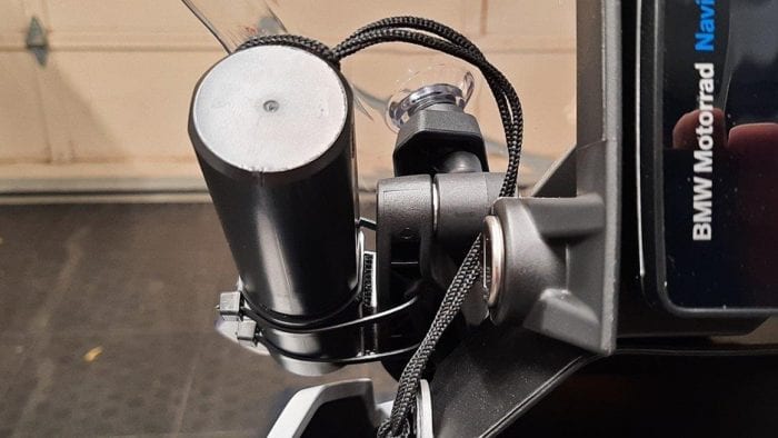

Motorcycle Installation Notes
While not divulging on what motorcycle and where the Monimoto is installed regarding the home fleet machines, some decent hiding spots are available; but not specifically identified here for obvious reasons; secrets are best kept as secrets, right?
There are some placement and performance cautions, however. It is best to have the slimmer GPS-marked end oriented UP or in a relatively unencumbered spot with a good line of sight to the skies, e.g. – under the seat or a single layer of plastic, but not behind one or two layers of frame or underneath a piece of metal luggage.
The other primary caution relates to keeping the Monimoto device physically away from onboard electronics or computer systems as this tends to or can interfere with wireless communications including both GSM and BT and optimal performance of the GPS receiver.
Both removable sections of the Monimoto housing have corner pass-throughs to use in securing/hanging the device although these points have not proven the best solution for the three motorcycle placements undertaken so far, but they are good for safety loops.
For more direct mounting applications and a bit of cushioning a heavier foam bicycle grip is cut into rounds and two put around the perimeter of the device and zip ties looped around the foam rounds to secure the device to the motorcycle part (tubing works well).
Another option now in use has 3M Dual Lock sections stuck to one surface (side) of the device housing – one towards each end. The module is light enough and the 3M pieces strong enough to keep the module secured; so far, so good.
Monimoto GPS Tracker mounted on motorcycle

The batteries and the provided (two month use) international SIM card were preinstalled (appreciated), but I decided to take the module apart anyway, cause that is what I do. And there will be a time when the batteries need changing and possibly, the SIM card.
In first attempting, then succeeding on the second effort to remove the shorter larger and very tightly fitted outer section of the module, the first somewhat negative observation is made – it takes a fair bit of effort to remove this piece.
And this brought to mind that given the force needed to remove this cap and as the intent is to have the Monimoto device mounted in a hidden and possibly hard to reach spot, periodic replacement of the (long life) batteries will be almost impossible without the module being removed first – note made.
Battery replacement – with the thicker end housing slowly wiggled off, one battery and the SIM in its slot is visible. Hold the inner piece and gently pull the other housing off to fully expose the inner component frame housing the battery slot.
Push down slightly and pull up on the top battery to remove them both. Note – wait at least one minute before installing new cells (to allow onboard memory refreshment).
Put the new cells in, make sure they are fully seated and then slip the (keyed) thinner outer section (GPS marked section over the frame making sure it snaps into place, then push the larger cap section on. The slide-on sections need to be fully seated, to maintain housing integrity.
Internal battery for Monimoto GPS Tracker
Batteries – the two batteries for the Monimoto device (builds MM1 thru MM7), are CR123A cells, available from Energizer, Duracell, Panasonic, Varta, GP, and Jauch. The Monimoto Keyfob (KEY3) uses a single CR2450 battery from Energizer, Panasonic, Varta, GP, Jauch, Renata, and EEMB. Energizer or Varta are the recommended batteries that work well with Monimoto.
A push notification is provided when Monimoto battery level falls below 20%; do not wait until they are totally depleted but replace them once notice is provided. Connecting to the device via the App ‘Settings’ provides a battery status check. The Red LED on the device also blinks once per second when the battery is (very) low.
SIM Card replacement – with the shorter outer housing removed, the SIM card slot is visible just above the ID sticker. The slot is fixed (not spring-loaded) and the original SIM is pliable so it must be worked out carefully – a flat jeweller’s screwdriver works (be careful not to damage the contact surfaces). A new SIM formed of plastic is here ready to go in and it should be a bit easier to install or remove as needed.
Mobile Data – Monimoto will use mobile data if it is enabled on any replacement SIM card – this improves accuracy along with the speed of location tracking and SMS text message services, although extra charges may apply depending on your service provider and any plan.

From this point, the setup and configuration process described earlier is completed on the Samsung XCover Pro phone, although it took three passes to get Monimoto found so it could be added (+) but once past this hurdle, the ‘Success’ screen showed up soon after. All good to go.
Monimoto device battery life – Alarm Mode is the biggest drain, so minimizing false alarms, such as occurs when moving the Monimoto out of range with the Keyfob – testing or otherwise. New batteries should be good for up to 500 location notifications.
Monimoto Keyfob battery life – as the essential validation part of the system, any kind of motion or vibration that activates the communication link increases draw on the battery.
While riding the lowest consumption is when the Keyfob is close to the Monimoto (it sleeps). But while parked the lowest consumption is observed when the Keyfob is outside of the range (typically 50m + or around 160ft of the Monimoto.
This implies that carrying the Keyfob with you all the time is not efficient, and this is true. However, for obvious reasons, the Keyfob should not be left next to your motorcycle either. But other than adjusting physical separation distances, there is a simpler way – see below.
Keyfob Range Management – (MM5/MM6 models from FW v1.1.2.0+) to address proximity and battery life points made above Monimoto now provides the ability to reduce the Keyfob signal range. Place your Keyfob where it’s normally kept (other than on you), launch the App and ‘Connect’ to the device, under Settings’ select the Keyfob menu and reduce the range slider slightly.
Monimoto GPS Tracker key fob management app screen
The Keyfob will restart and the screen refreshes and you will see if the Keyfob still connects (active screen vice greyed out). If it connects easily, reduce the range slider in increments until the Monimoto device no longer links (connects) to the Keyfob; this helps battery life, but also increases the chances of false alarms being triggered during use.

Versatility in Use – along with the intended motorcycle use, its features, such as being totally self-contained and very portable, make it an ideal silent alarm and tracking solution for powered and non-powered platforms for even better continuing return on the investment.

The Bottom Line – Monimoto is ruggedized and waterproof with an IP65 rating. Its passive movement detection and tracking features combined with cellular GSM capability and BT communication link for the companion Keyfob and paired personal smart device make for one very complete and very functional package. Even if you have an OEM or third-party alarm installed the Monimoto deserves a serious look. Its ability to be used for almost any type of activity – powered and non-powered platform related make it an excellent security and safety investment.

Box contents of Monimoto GPS Tracker laid out on table.
Diagram of internal components for Monimoto GPS Tracker
