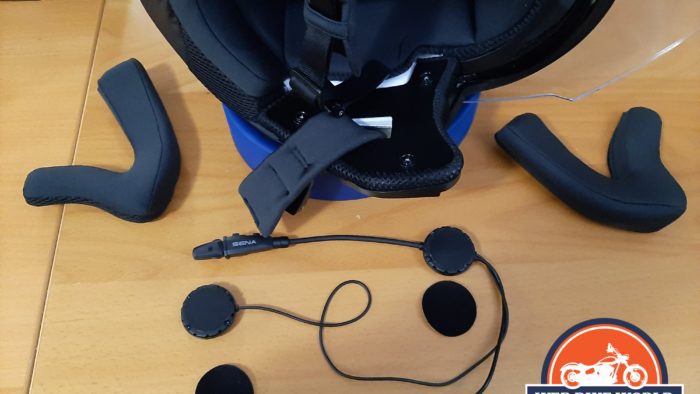

The Sena 3S Plus Boom version is very much the simpler system regarding installation components – the enlarged boom microphone piece integrates the end-placed microphone, two controls, and other components, with the boom itself integrated into the left speaker housing; only the right speaker is on its own long lead wire.

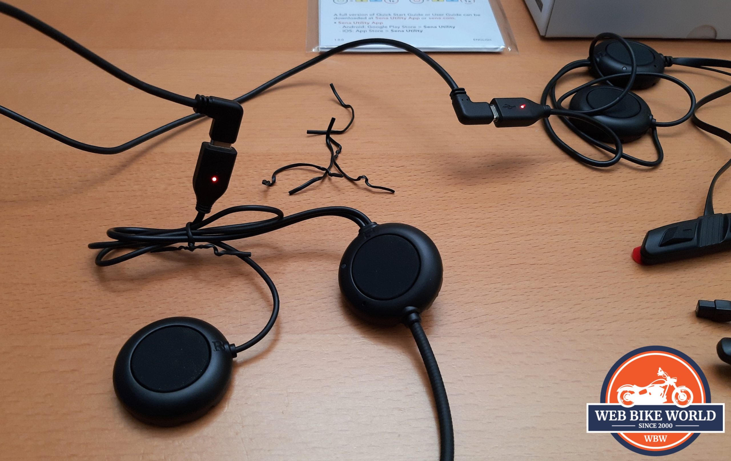

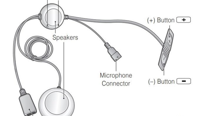

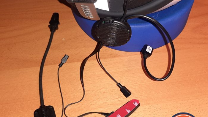

On the other hand, the Sena 3S Plus Universal is just a little more complex but more adaptable in having a separate small control module that fits onto the helmet and is connected to the left speaker housing with a short lead.
In addition to the module lead the left speaker housing hosts the right speaker lead, the USB Type C cable for charging/firmware updates, and the microphone connection lead that supports the use of either the thin-wire or boom microphone, both included in the Universal kit.

The Sena 3S Plus Boom Model​
Sena 3S Plus, Boom System, kit contents laid out

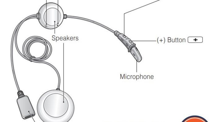

Simplicity and efficiency in a small integrated BT system ideal for installation in Jet Style or Three-Quarter open face helmets or similarly shaped PPE.

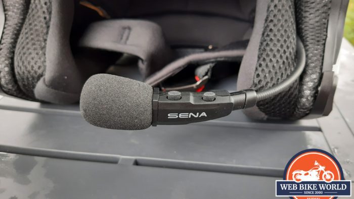

Integrated microphone and control module incorporated into the shaped housing on the end of the boom that is integrated into the left speaker housing, with the right speaker lead and the USB Type C interface cable integrated into the left speaker housing as well, forming a single piece system.
There are only two input controls, both located on the upper side of the control module section on the boom. The Plus (+) button is closest to the microphone and the Minu (-) button is to the back.
These controls are readily accessed with light to medium weight gloves but can be difficult to access easily with heavy cold-weather gloves unless the boom is pushed forward to provide better access.
The Sena 3S Plus Boom kit includes – the integrated boom microphone housing with controls and left stereo speaker housing; a wired right speaker; mounting pieces for speaker and microphone installation; a USB Type C power/data cable; and a small foldable pocket-sized Quick Start Guide. The full Sena 3S Plus User Guide is available online.

Sena 3S Plus, Universal System, kit contents laid out
The Sena 3S Plus Universal model is not quite 100% usable on (any) helmet as the speakers do need an interior or side-wall surface of some type for mounting that may or may not be present in most half-helmets, but for many (many) helmets, its modularity allows for an effective installation.
Its detachable thin wire or boom microphone options and small externally mounted control module provide lots of fitment flexibility between Jet, three-quarter, modular, and full-face helmets and some hybrid style helmets based on short or half-helmet designs with more side shaping.
Like the Boom model, there are only two controls on the Universal model – both located on the face of the sleek low-profile externally mounted module and, both distinctively shaped for feel and use with any weight of gloves.
With the helmet worn, the Plus (+) control is at the front and the Minus (-) control at the back. The short flat connection harness between the module and left speaker housing is securely fitted into both housings.
The Sena 3S Plus Universal kit includes – adhesive-backed externally mounted module; thin wire and boom microphones; mounting pieces for speaker and microphone installation, a USB Type C power/data cable, and a small foldable pocket-sized Quick Start Guide. The full Sena 3S Plus User Guide is available online.

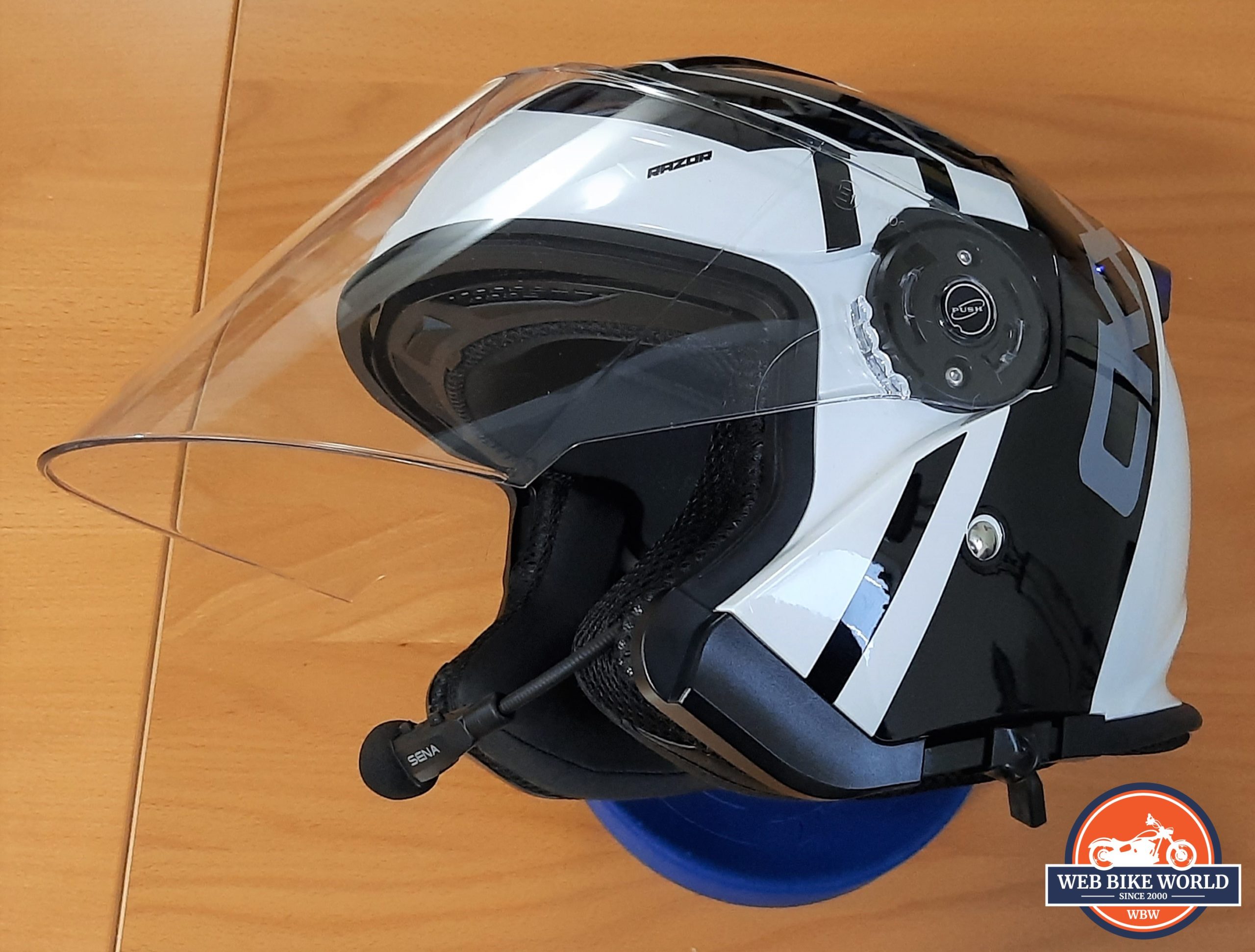

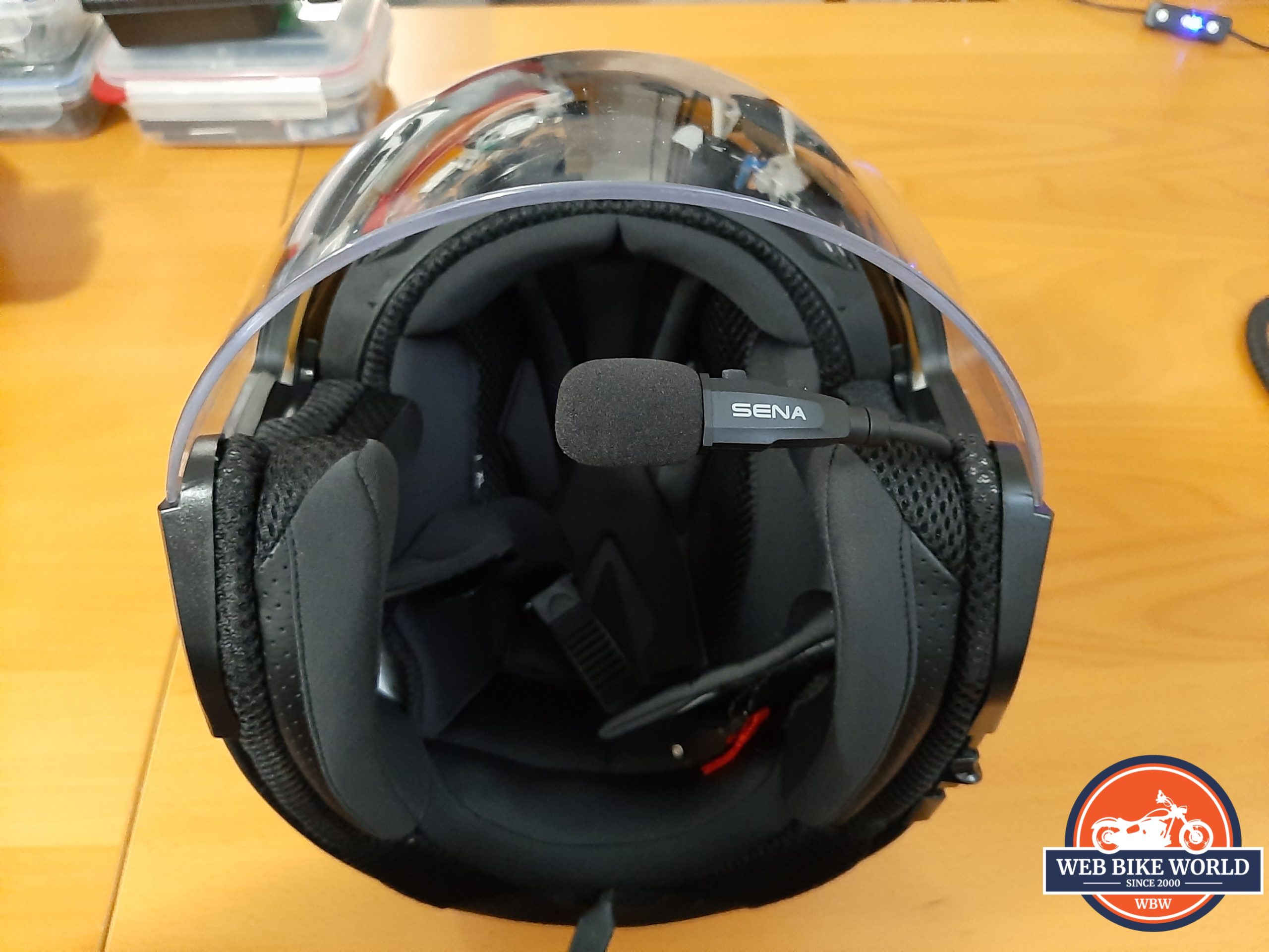

Sena 3S Plus, Boom System, on CKX Helmet, ready to go

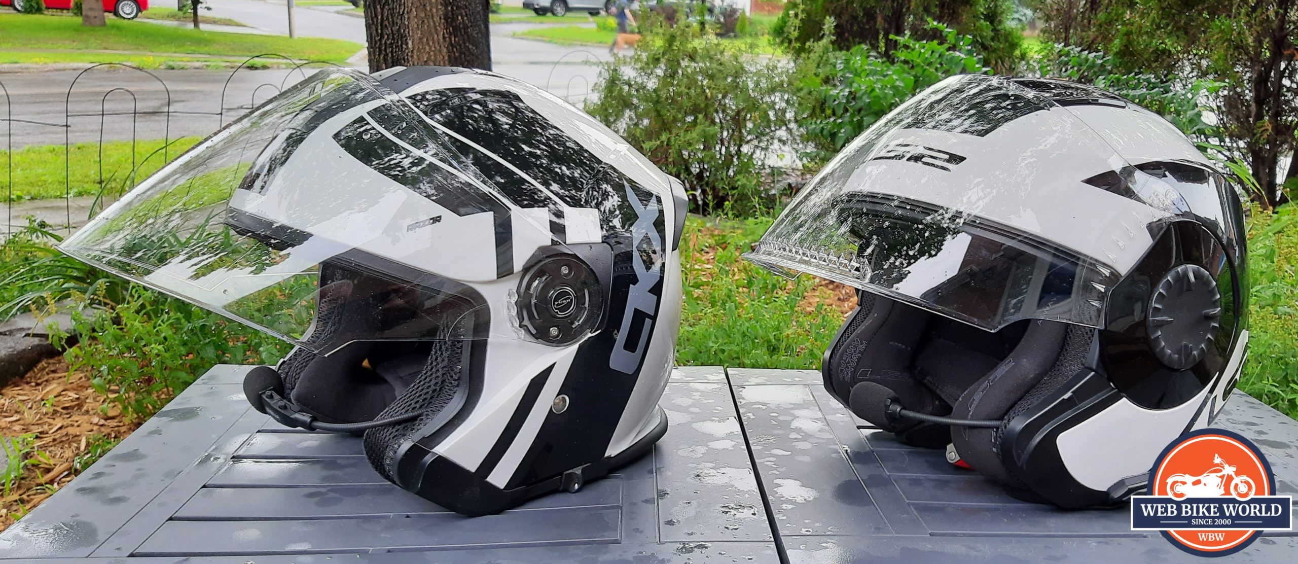

CKX Jet Style Helmet – one word describes the effort here – ‘easy’. After scoping the CKX interior layout for a minute or two, the three (real) metal snap-fit fasteners used on each cheek pad are separated from the inner liner and put aside and two brushed speaker backing rounds are laid in place in the reasonably well-defined speaker recesses.
This is followed by the left side speaker with boom microphone assembly being fitted in place and then the right individual speaker piece. With the cheek pads snapped back into place, we are done; total elapsed time- about three minutes.
Routing of the microphone boom between layouts for two of the snaps provides good positioning and support, although since the initial installation, the small adhesive-backed cable support used for motorcycle installation work is now mounted to the left liner wall and with the boom nestled in the support, and the cheek pad reinstalled, the assembly is even more stable.

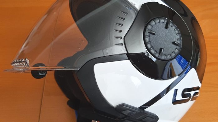

Sena 3S Plus, Universal System, on LS2 VERSO, ready to go
LS2 VERSO Three-Quarter Helmet – this helmet gets lots of use especially during warm weather commuting and it hosts numerous helmet headset systems; it already has brushed (loop) rounds mounted in the speaker recesses along with some extra loop fastener sections positioned along the lower left inner side of the liner to facilitate boom microphone mounting.
With the supplied hook-side fasteners aligned and stuck to the back of the speakers and the side pads pulled away from the three snap inserts on the inner liner on each side, full access is provided so it does not take long to install the multi-part modular 3S Plus Universal.
The right speaker and lead are run under the head liner over to the right side and the speaker fitted in place, but the left speaker installation takes a bit more consideration as there are multiple connection leads emanating from the left speaker housing.
The right speaker wire and thicker USB interface lead emanate from one point on the speaker housing, but the microphone and BT module leads both exit on the opposite side of the housing so two pathways need to be considered regarding best orientation, especially if the boom microphone is to be used rather than the more flexible thin-wire piece.
On the LS2 Verso, the right speaker and USB leads are oriented up – the right speaker wire crosses over the top back to the other side while the USB Type C interface cable runs down behind the speaker and liner to tuck under the back neck roll for easy access when needed.
The microphone connection lead is mated to the mini connector on the microphone and routed between the cheek pad and inner lining closer to the bottom of the helmet, so it does not interfere or get caught up in retention strap movement.
With the small BT module stuck to the left lower edge just above the black edging piece and positioned in line vertically with the left shield plate (also the sun visor adjustment wheel), the main harness between the left speaker and module runs forward a bit on the outside and then turns in between the magnet-secured front edge of the neck pad and the cheek pad.
Once the microphone connection is made and its lead routed out of the way, the supplied plastic mounting plate with its hook fastener is secured over the boom to the loop material on the helmet as a support along the way with the boom positioned between the lower and upper cheek pad inserts for a secure but readily adjustable fit once the cheek pad is reinstalled.
With one of the two supplied foam windsocks fitted this installation is done. For charging and updating purposes, the USB Type C cable is pulled out of the back neck liner and connected to the interface cable.

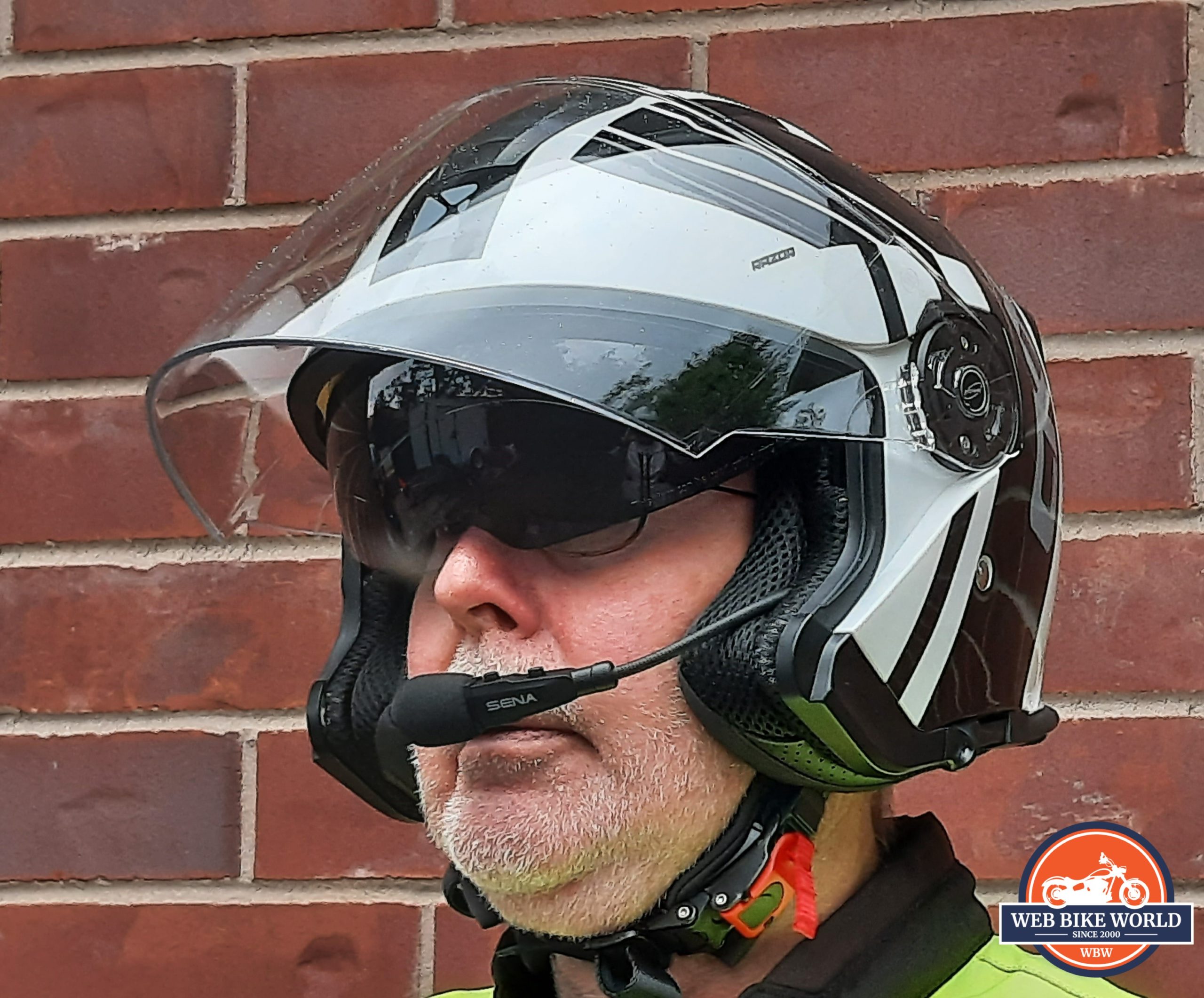

Sena 3S Plus, Boom System, on CKX helmet, worn
The speakers in their thick hard housings are listed as providing HD audio, and for intercom and audio they are more than up to the task, but when compared to many other speaker sets used by Sena and other brands, including those in lower-cost models the Sena 3S Plus speakers are definitely lacking in overall output and quality.
Audio Sources – there is no audio overlay capability, so one audio source can be heard at a time; with the functional priority being (1) mobile phone, (2) intercom, and (3) BT stereo music. If listening to music, an incoming phone call or intercom activation bumps the music streaming.
An exception to this is when one device with multiple audio services active (Calls, Audio) is used along with an installed and launched navigation App that is configured for audio output.
During music streaming, mono navigation instructions will be heard overlaid on the music streaming, with the instructions in the foreground and the music in the background; the music volume resumes once the instructions are finished.
Audio Switching – switching between paired/connected audio sources is fast (a good thing given its single audio source limitation, with only one or two dropped or delayed switching scenarios encountered.
Moving between phone calls, intercom, steaming music and, input from the BMW Navigator VI or the onboard BMW Connectivity TFT is pretty much seamless.
AVRCP – control of music streaming from a connected device (with the respective audio playback app launched on the device) is started or stopped by pressing and holding the (+) button for one (1) second. To move forward or backward in tracks, press and hold the (+) or (-) button for two (2) seconds respectively.
Cockpit and Helmet Environment Impact – volume output is actually quite good, which helps (in one way) when noise levels climb in the cockpit and the more open to the elements three-quarters with full shield designed helmets.
As speed and noise build, the user can detect the Advanced Noise Control (enabled by default) capability working to optimize voice comms while reducing ambient noise; it is a most welcome and effective feature.
But there are still limits and at the highest speeds most audio becomes hard to hear; but again, this is as much due to the style of helmets in use.
The speakers in the 3S Plus systems are well suited for intercom use but not optimal for listening to a quality stereo stream or other streaming audio; although having said this, these assessments are as much subjective as objective and other users may find these speakers just fine for their specific use.
And in coming to the defense of the Sena 3S Plus systems both have been tested in full-face and modular helmets and the audio experience in these encompassing quieter helmets is much better, although the speakers still lack tonal quality.

Sena 3S Plus, Universal System, on LS2 VERSO, very low profile
Sena 3S Plus, Universal System, on LS2 VERSO helmet, worn
Sena 3S Plus, Layout, Retail Packaging
Sena 3S Plus, Layout, Universal and Boom Systems kits laid out

HERO image: Sena 3S Plus, Helmets, CKX with Boom and LS2 with Universal systems
