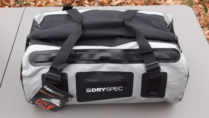

And this brings us to the products used for this review, the D78 Modular Packing System, a combination comprised of the D20 Dry Bag Saddle Set and a D38 Rigid-Core Dry Bag from the Twisted Throttle DrySpec D-Series line of drybags.
Front face of the DrySpec D78 bag

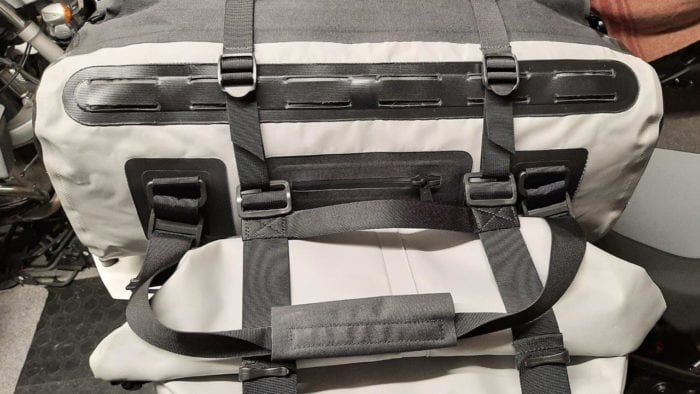

Side view of the DrySpec D78 Modular Packing Bag
First impressions are important. And our first impressions of the D-Series modular packing system products, the DrySpec D-20 Dry Bag Saddle Set and the D-38 Dry Bag are all positive.
The pieces selected for this review were in Grey with black strapping and Modular Lightweight Load-carrying Equipment or MOLLE layouts. While not as conspicuous as the Orange option this tone is more defining or visual than black and the flat grey works well with so many common motorcycle paint schemes.
What really stands out are the common features between the two dry bag products – some are readily evident from their exteriors with more revealed once the dry bag roll-tops are opened; everything reflects common sense, experience, great design, build quality and, versatility.
The DrySpec dry bags look good whether on the bench or mounted on the motorcycle, empty or full; traits not always seen with soft side or hybrid luggage pieces. And this ‘looking good’ is due in large to their Rigid-Core liner that provides distinct shaping and form as well as padded security for contents.
And this padded rigidity makes packing, finding, and removing packed items much easier as well as the interior remains a shaped accessible space and the bag does not collapse or lose its basic shaping as contents are removed or adjusted, which is another benefit gained in that less ongoing adjustment or tensioning of straps is needed.

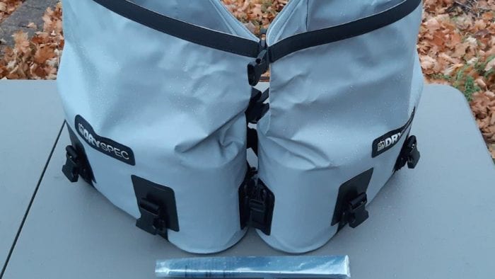

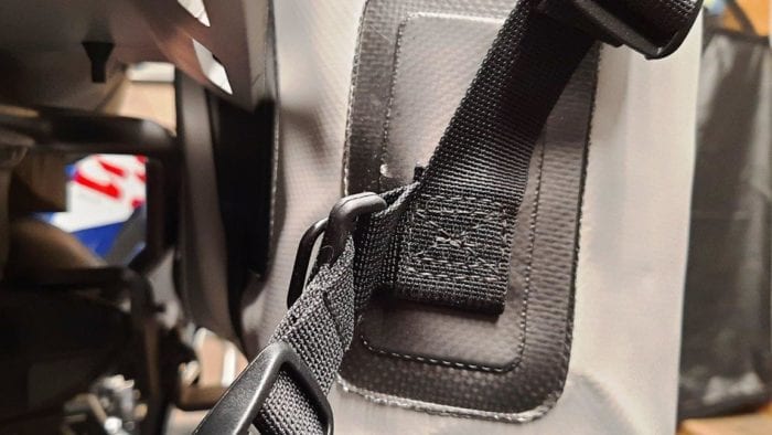

The roll-top design is another common feature between the D20 and D38 dry bags, although whereas the D20 dry bags have a full roll-top opening the D38 dry bag roll-top is gathered a bit and does not provide the same direct access to the interior as with the D20 dry bags.
When the roll-tops are in use, their end (F) buckles are attached to the adjustable (M) buckle sections found on the ends of the dry bags. These attachment point inserts are RF welded and the buckles are on short adjustable straps for pull-down tensioning and security.
Original objectives for the DrySpec dry bags were to make them (very) durable and (absolutely) waterproof; many early drybags were neither. And thanks to their 22oz vinyl construction with RF welded seams and coated Cordura panels the D-Series dry bags are both 100% waterproof, even when submerged or perhaps used as a flotation device and, proving to be (very) durable.
Last but certainly not least is their modularity so that individual drybags can be used together to form a system solution without compromising any one component while creating a safe manageable multi-piece packing solution.
Increasing capacity of this modular system is easy – use another D-series drybag of greater or lesser capacity and connect them together using the adjustable straps, integrated sliders and MOLLE layouts; outstanding flexibility and ongoing adaptability regarding use for any requirement or packing scenario.

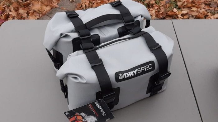

The DRYSPEC D20 Dry Bag Saddle Set​
DrySpec D20 side bags

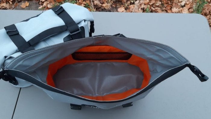

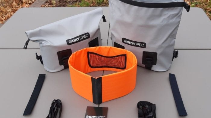

Like all DrySpec dry bags, the D20 pieces use an internal rigid-core insert so the bags retain their shape even when empty, making packing and unpacking easy. The insert fits in around the perimeter of the dry bag and with the Velcro overlay strips secured together the dry bag has great semi-rigid form.
The individual inserts are quite stiff and very sturdy, but removable – separate the Velcro sections and work the insert out of the bag, made easier thanks to the full wide-mouth roll-top. If the inserts are removed the bags can be collapsed flat for storage or even packed with other luggage and taken along as spare pieces – more versatility.
The individual D20 dry bags measure 43.18cm x 15.24cm x 30.48cm (17 x 6 x 12in) based on Length x Width x Height layout. The capacity of each D20 dry bag is, you guessed it ~20 litres, for a set total of 40L, give or take depending on packing approach.
The full-length roll-top access really does simplify packing and accessing something quickly or in unpacking is easy, whether smaller individual stuff sacks are used to separate clothing or gear or if everything is just laid out (or stuffed) in the bag; everyone has their own method, although folding, rolling and layering items really does help in utilizing all available space…
A key part of the D20’s versatility is the interchangeable centre strap or cross-over options with both Velcro or nylon flat strap sets provided allowing the dry bag saddle set to be mounted to a motorcycle with or without side racks (see Installation Section below) or used separately with or without other D-series dry bags – you decide.
The included Velcro centre straps facilitate a quick hook-n-loop approach for standard over the seat layout placement but with a bit more profile and less flexibility of sorts, while the 38mm (1.5in) wide nylon flat straps are usable over the front or rear portion of the seat without being felt per se and provide more flexibility in routing, even under the seat.
And when not used the wide nylon flat straps can be safely stowed in the small outer side flat zippered pocket – that has a retro-reflective logo on its outside for side-view conspicuity (every little bit helps). The heavier duty Velcro cross straps are stowable inside the bags.
The D20 dry bag saddle set is available in Black, Orange, and Grey. An optional DrySpec Universal Exhaust Heat Shield for 4 to 6 in diameter mufflers is available and if there is any doubt regarding related clearances or heat, then fitting a shield is (highly) recommended.

The DrySpec D38 Rigid-Core Dry Bag​
DrySpec D38 core bag
The DrySpec D38 piece uses a sturdy one-piece removable rigid-core insert that provides both a floor and sidewalls and is secured in place (not really needed) with three snaps per side.
This rigid-core insert is a great feature – strong and lightly padded and a stretch mesh pouch is positioned on one of the interior walls, opposite the outside zippered flat pocket (that also sports a retro-reflective logo).
The sidewalls of the insert extend up just slightly higher than the outer wall MOLLE inserts, forming a sturdy backdrop or support surface for when the MOLLE inserts are used, such as when connecting other D-Series dry bags.
Unlike the D20 dry bag inserts, however, the D38’s rigid-core insert is not easily removed due to the Cordura roll top section being gathered at what is the bottom of the roll-top, creating a less than full-sized opening. Access to the interior is still good, but not as easy as with the D20.
This Cordura insert is lighter and more pliable, but it seems out of place when the rest of the dry bag uses the heavier duty 22oz vinyl material. Getting rid of this insert material and providing a full roll-top opening would be great changes for any subsequent version…
The D38 dry bag measures ~56.5cm (22in) Long x 32cm (12.6in) Wide x 28cm (11in) High, with a capacity of, yep, 38 Litres, give or take depending on packing ability. The D38 Rigid-Core Dry Bag is available in Black, Orange and Grey.
For positioning and securing the D38 on the back of the seat or rack – across or lengthwise, the D38 dry bag has four adjustable slip-lock mounting straps with frame loop ends and a long dual-end slip-lock strap. Layout and mounting options are identified in the Installations Section.

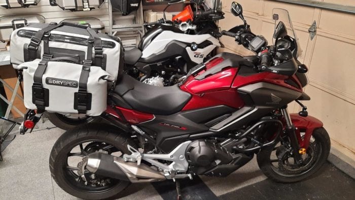

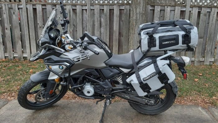

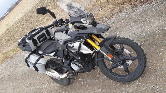

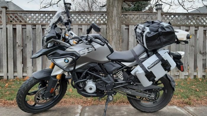

The DrySpec D20 and D38 dry bag kits were laid out on multiple motorcycles for visual assessment and with a bit of adaptation, none of the motos are likely to be an issue regarding fitment of these products.
Four motorcycles (BMW G 310 GS, F 750 GS, F 850GSA, and a Honda NC750X) ended up hosting the kits for assessment and photos, with the G310GS and the Honda wearing the dry bag installations for road testing and use over varying periods of time; most of the narrative below is based on the G 310 GS installation.
Dry Spec D38 bag with straps
The D20 and D38 dry bags, used separately or together, provide one of the best solutions going for a wide variety of motorcycles, no matter if small displacement machines used extensively for single track and trail use or, larger motorcycles that do a bit of everything.
Whether a first-time user or more experienced in mounting this type of luggage, it pays to read through or use the small (stowable) DRYSPEC D-Series Instruction Manual. This booklet covers the individual kits and the typical combination layouts with strap use clearly identified.
DrySpec D78 bags mounted on motorcycle
This kit doesn’t really need a side frame, depending on the motorcycle, but a side frame kit, even lightweight skeletal pieces are good in providing side support, needed clearances between luggage and motorcycle components, and providing strap points.
While the D20 dry bag saddle set can indeed be mounted higher up, taking advantage of the side of the seat and side-plastic panels for support and to maintain clearances, it’s not ideal for overall load placement, especially when side frame pieces are installed and available.
Numerous slots and cut-outs on the side frame plates allow the individual D20 bags to be fitted directly to the front down-angled side frames using the slider straps and MOLLE panels on the dry bags. But, as the overall objective is to keep the D20 set as a set and keep them easy to put on and take off, the over the seat solution is used as a starting point.
The D20 dry bags can sit lower against the Rally Raid side frames with the cross-over straps adjusted to provide a mounting angle to match the side frame orientation. But the Velcro straps end up being a bit short when run across the seat and are too heavy to be routed under the seat, so the 54cm or 21.25in flat nylon straps are used, although they are also too short.
But in taking a big roll of 3.8cm or 1.5in nylon flat strap from the storage bin, two longish straps, each 81cm or 31.8in in length, diagonally cut and heat sealed to provide the length needed, with some extra (seldom a bad thing). The diagonal cut helps run the straps through sliders or buckles and heat sealing keeps the ends from fraying easily.
These straps are laid out over the seat and although the front one sits across the back portion of the rider’s seat it is not noticeable. As expected, and as will be possible with many motorcycles the straps can be run under the seat and/or across the back of any tail section; just keep it all safe.
Once the D20 dry bags are positioned on each side to match the side frames, the short slip-lock mounting straps are brought into play to secure the front lower ends of each dry bag. Loop each strap through a (hopefully) convenient point – usually on the frame or passenger peg assembly, although the G 310 GS has well-positioned heel guards that work.
Now run the straps back to the lower front mounting points and with the slip-lock pieces laid flat push them through the 25mm or 1.0in (vertically) mounted plastic loops; the slip-lock pieces will not slide out once engaged on the opposite side of the loops.
Tighten the straps up with the sliders and use the plastic retainer to fold and tuck the excess out of the way. The retainers may or may not work very well, and if the excess works loose, wrap it around the strap and then use the retainer, or if the installation will have some permanency, use small zip ties or hook-n-loop wraps. Keeping strap pulls and ends securely minimizes slippage as well.
At the back, the long dual-end slip-lock strap is the bridging piece. Connect one of the slip-lock ends to one of the rear plastic loop points then route the strap across the back of the motorcycle, either across or under the tailpiece as used for the G 310 GS or, across and over the license plate frame mounting point; either of these options usually works well.
The objective for the back strap is to pull the bags back and down until there is even tension and the pieces are secure; don’t be afraid to spend some time trying different approaches; it’s all part of the learning experience.

With the loop ends secured, run the straps up to the 1.0in plastic loops found on the lower ends of the main side strap assemblies, mount the slip-lock pieces through the loops and then use the slider to adjust each strap until the dry bag sits evenly and securely. Make sure any excess strap is wrapped or tucked away using the retainers.
On the BMW G 310 GS or the Honda NC750X, no matter whether the bag is positioned parallel or perpendicular on the seat and/or back rack, all four slip-lock straps are usable or with the two front straps in place, the single longer dual end slip-lock strap is used for the back as it bridges the distance across or around most parts.

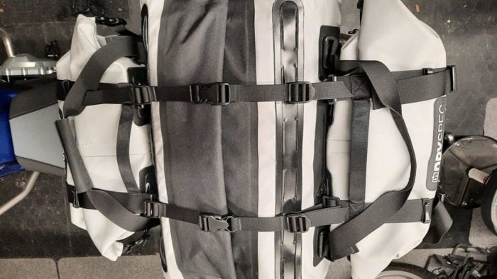

D78 Modular Packing System – Sum of the Parts​

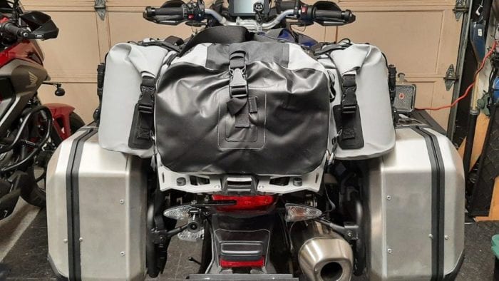

When the D20 and D38 pieces are to be used as the D78 modular combination, then a bit of preparatory work is needed, unless the D20 dry bag saddle set is already installed, in which case the D38 need only be added. Either way, once the basic steps are understood, forming the combo is quick and easy – as intended.
When bringing the D20 saddle set and D38 bag together, the two-piece D78 combo straps, with their centred quick-release connectors, from the D20 kit are brought into play. Lay these two straps out over the top of the D38 and run the ends through the (second from the end) MOLLE pass-throughs on the D38 bag.
Run these ends down to and through the top bar of the (3-bar) slider on the top rear of each D20 compression strap, then back up to the tension or slide-lock buckles on the combo straps and route the ends of the straps through these buckles. This layout provides the means to both connect and adjust the height differential between the D38 and D20 pieces.
If the D20 set is already mounted and secured, some loosening of the lower front and back straps might be needed so that the D20/D38/D20 sandwich layout can be brought closer together to form a solid modular system.
With a bit of slack in the lower straps and with the D20 compression straps buckled, take their ends, and pull them up firmly which serves to tighten up (compress) the fit between the D20 dry bags and the centre D38 dry bag. Do this for both sides and then make sure the ends of the compression straps are (again) secured in their strap retainers.
The lower front and back mounting straps attached to the D20 dry bags can be tightened up fully to secure and tension the now formed modular packing system that is easily removed by detaching the lower mounting straps.
Once laid out and secured for the road, access to the interior of the D38 dry bag is still provided by using the (middle) quick release connectors that secure the two halves of each combo strap together and then releasing the roll-top end buckles so the roll top can be opened for interior access, all with minimal disruption of the modular packing system.
Various angles of D78 bags on motorcycle

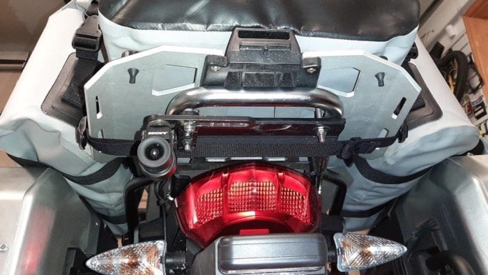

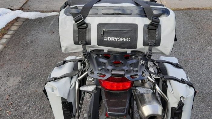

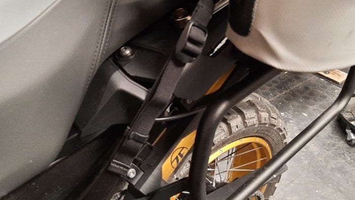

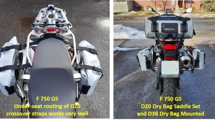

The F 750 GS benefits from having the BMW Adventure Side Pannier frames installed along with a small adapter for the off-set layout on the right side needed when the Kriega OS-Adventure Kits are installed as mounting bases for larger soft luggage pieces like the Wolfman Rocky Mountain Expedition Saddle Bags WP evaluated earlier this year.
If there were no side frames installed, the D20 dry bag saddle set would be fitted higher to use the side of the seat and side plastic for support and both the Velcro or nylon cross-over straps would work. But with the D20 dry bags positioned to sit against the pannier frames the longer custom length nylon straps are needed.
After routing these front and rear cross-straps through the 3-bar slider on the top of the wide compression straps on one side they are run across (over or under) the seat and over the deck (front and rear respectively) and then through the 3-bar sliders on the opposing bag with needed height and angulation adjustments made as needed.
The lower front straps loop through the rear cut-out sections on the passenger peg assemblies while the long dual-end cross-over strap connects to the rear slip-lock mount on one D20 and is then wound around the cross-tube support for the BMW pannier kit over to the other bag and connected – it is just the right length (snug), so no tensioning with the sliders is needed.
As identified earlier, the small Kriega off-set adapter that sits on the upper frame tubing of the right pannier frame now comes into play, providing a support point for the upper edge of the D20 dry bag to sit against so it has a vertical layout to match the left side.

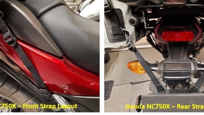

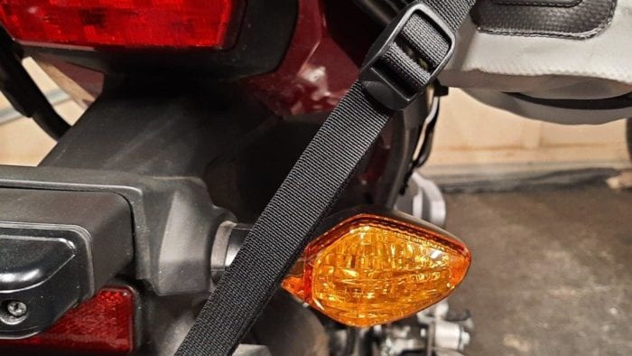

The Honda NC750X is the only motorcycle used that does not have some form of side frame kit installed making it a good candidate to further assess how well the D20 and D38 products work by themselves and when in the D78 combo – very well as it turns out.
The D20 dry bag saddle set goes on first with bags installed, using both the Velcro and nylon flat straps from the kit, laid out across rear portion of the seat and the back deck (front and back respectively) with the four slip-lock straps (two from each kit) used, although the single long dual-end slip-lock strap also works well for the back mounting.
With the D38 dry bag placed across the rear of the seat or back rack or perpendicular on the seat and rack, its four (long) slip-lock straps are used. The front straps go to the same trellis-frame point as used for the D20 straps (per the photos) with either two rear straps used as tethered to individual points on the license plate frame or the single long dual-end strap used.
Various angles of D78 bag mounted on Honda NC750X

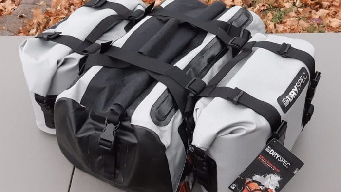

To form the D78 Modular Packing System the D20 straps remain in place and the individual long mounting straps used for the D38 removed. Then the D38 interconnection steps described earlier using the D78 combo straps are completed and with all the straps checked for routing and tension, it’s done.
From a layout perspective, the D20 dry bags, with the combo straps adjusted for full layout are about 60% down the sides of the D38 dry bag with the lower part of the D20 bags resting against the side plastic and SW-Motech rear rack side rails.
This visual layout clearly reveals how much the side bags can be dropped down while still interconnected. Empty or loaded (with about 25kgs or 55lbs) of gear between the three bags a bit of back and side loading is felt but the combination is secure and the motorcycle stable. And no, the signal lights are not obscured at the rear by the straps…

Migrating the DrySpec D78 combination from the Honda over to the F 850 GSA is simple – release the lower D20 straps and lift the complete combo away and then lay it out on the back of the GSA; that was (truly) easy.
And the only thing needing adjustment, done within a minute or two, is to move the D78 combo straps to the first and fourth (from the front) MOLLE pass-throughs, to reposition the D20 dry bags forward so they sit on the tops of the TERRA side cases – as envisioned, with no impact on access to the side-loaded TERRA case interiors.
There is more versatility to be made of these dry bags piece as well – if separated the individual D20 dry bags work great as auxiliary storage bags mounted on top of any side pannier cases or as was done with the F 850 GSA, mounting one on the lid of the TR37 top case using its four corner mounts.
Outdoor photo of D78 bag mounted on BMW bike

Fitting and using the pieces on the versatile G310GS for much of the review period only seemed natural given size and use of the motorcycle, and size and look of the DrySpec pieces; the result is one of the best luggage combinations seen and it works extremely well.
There are no load stability, handling, or ride issues whatsoever whether the bags were loaded or empty, while trolling along or running at highway speeds; the owner of the motorcycle is most impressed with the configuration. This assessment is a testament to the design, construct, and installation flexibility of the DrySpec products.
The dry bags are indeed light in weight with the rigid-core insert providing form and cushioning to protect the contents. The exterior is proving durable (and cleanable) and the roll-top design provides great access and an absolute waterproof seal when rolled properly (3 is the minimum).
Issues are minor and the observations to be raised are summarized below:
  • D20 cross-over straps – both the Velcro sections and the nylon straps could be longer, adding another 10cm or 4in would be good. And increasing the length of the wide nylon straps by 20cm or around 8in would work
  • Adjustable straps – the slip-lock ends are relatively easy to use, but for a quick disconnect capability, changing the slip-lock ends to small quick-release fasteners or leaving the ends as is (slip-lock and loop) and adding a small M/F quick disconnect in the middle would be good
  • D38 Roll-top – the D20 dry bags have a full wide-mouth roll-top but the D38 piece uses a Cordura insert top and the roll-top is gathered, restricting easy full access to the interior; a full wide-mouth layout is recommended, which would also allow the liner to be removed…
  • And although not specifically identified above, two users identified that it would be good to perhaps use or provide a set of 38mm (1.5in) quick release connectors so the cross straps could be turned into a quick disconnect feature if desired (we made this mod locally)
Fastening points and strapping is indeed minimal compared to other soft-side sets or modular-based dry bags, but this isn’t a negative as the layout of integrated strapping and individual adjustable straps provide everything needed, especially for when working with the D-Series dry bags and their common connectivity approach.

The D20 Dry Bag Saddle Set and D38 Rigid-Core Dry Bag pieces are usable separately as delivered or interconnected to form the D78 Modular Packing System solution. And each of the D20 dry bags are readily adapted for stand-alone use, perhaps even as a day bag of sorts, in which case it would be nice to have a shoulder strap for it…
Between their integrated straps, MOLLE sections and interconnectivity options, the various DrySpec modular packing system layouts offer excellent solutions for so many powered and (non-powered) applications; and, they play well with other products as well; versatility, flexibility and value for the investment.

DrySpec D78 Modular Packing System
