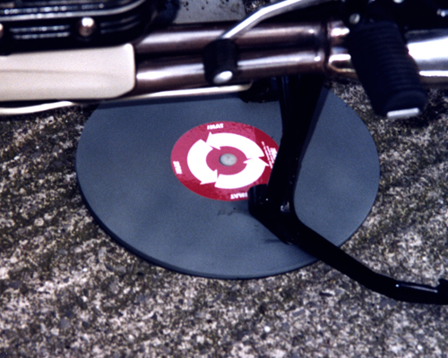

Hello all
I have been using one of the above for at least six years now.It is such a part of my routine for turning my bike and backing it into my garage I cannot imagine not having it.Over the years the rubber has come off and the centre now has a nut and bolt but still it lives on and does what it says on the tin.
I would thoroughly recommend this product and am rather suprised no one has mentioned one already
Safe riding
